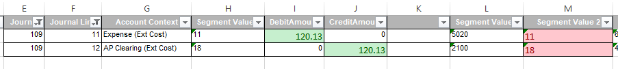

Would any one have a recommendation on the best way to write a BAQ to compare lines within a journal?
Trying to see where within a journal a credit amount = debit amount, but the segment value is different?
see below example - Thank you!!

Thanks - I’ll give that a shot. Our segment value 2 represents a location, and they should always match. I’m trying to pull out journal entries that are coded incorrectly.

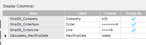

still stumped on the best way to write it - any ideas? Everytime I do a group by it says bad SQL. Is there some rule to Group BY that always needs to be followed? Thx in advance for any assistance
The app server log will give you a more specific SQL error
Sorry in advanced if there is more to this than what I assume, but I’ll answer this the way I am reading it.
Grouping in a BAQ needs a calculated field that uses an aggregate function (Max, average, etc.). And then all non-calculated fields are grouped. Like this:
