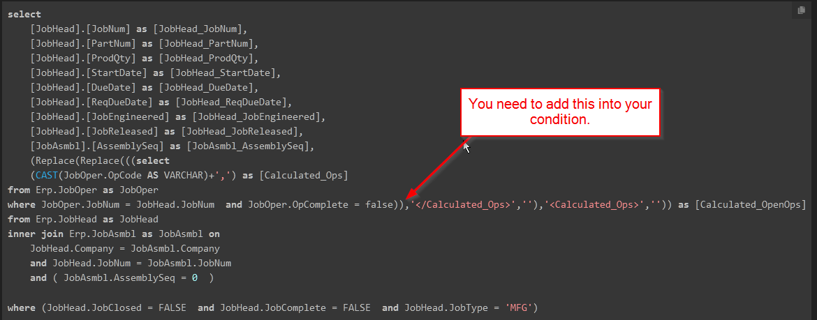

I tried to use the String_Agg and got the error that it’s not a built in function (we are probably on an older everything :slight_smile: )
I added the XML path back into the subquery criteria and it works, but returns all the ops, not just the open ones. If I try to put a filter on the subquery or the table in the subquery I still get an error. I’m not sure where I should put the filter.
select
	[JobHead].[JobNum] as [JobHead_JobNum],
	[JobHead].[PartNum] as [JobHead_PartNum],
	[JobHead].[ProdQty] as [JobHead_ProdQty],
	[JobHead].[StartDate] as [JobHead_StartDate],
	[JobHead].[DueDate] as [JobHead_DueDate],
	[JobHead].[ReqDueDate] as [JobHead_ReqDueDate],
	[JobHead].[JobEngineered] as [JobHead_JobEngineered],
	[JobHead].[JobReleased] as [JobHead_JobReleased],
	[JobAsmbl].[AssemblySeq] as [JobAsmbl_AssemblySeq],
	(Replace(Replace(((select
	(CAST(JobOper.OpCode AS VARCHAR)+',') as [Calculated_Ops]
from Erp.JobOper as JobOper
where JobOper.JobNum = JobHead.JobNum FOR XML PATH(''))),'</Calculated_Ops>',''),'<Calculated_Ops>','')) as [Calculated_OpenOps]
from Erp.JobHead as JobHead
inner join Erp.JobAsmbl as JobAsmbl on
	JobHead.Company = JobAsmbl.Company
	and JobHead.JobNum = JobAsmbl.JobNum
	and ( JobAsmbl.AssemblySeq = 0  )
where (JobHead.JobClosed = FALSE  and JobHead.JobComplete = FALSE  and JobHead.JobType = 'MFG')
The for XML has to be last, because this technique is are hackily (that’s a word right?) adding it on. So if you add other filters, make sure that they are before the line that has it.
