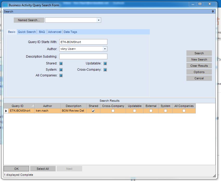

And does the BAQ have parameters? And are any set to ignore if null?
Make sure you have the right BAQ… Epicor during a dashboard import sometimes allows you to have a “All Companies” BAQ and then it creates a Local BAQ with the SAME BAQ Name without “All Companies” checked. It’s hard to find in a Dashboard…
So Make sure you do a good search within BAQ Designer, All Users, Shared / Unshared, All Companies / Not All Companies… See if you have another hidden one with the same name, or just rename your BAQ then add it back to a Dashboard any other name than ETK-BOMShort
I had a similar issue, I modified a BAQ it all looked awesome, until the Dashboard ran an older BAQ, so when I deleted My BAQ the other one showed up, it was odd… Back-up your ETK-BOMShort and then delete it =) see if there is another one. This may be a bug when using Dashboard Maintenance to Import. I had to delete the local ones for each Company so the All Companies one was used.
But then Again this might only happen in a MC Environment, don’t know - just double check. Rename BAQ See if that helps.
Obviously I wouldnt see another users if they didnt share it, so maybe someone from your colleagues managed to clone it with the same name who knows :slight_smile:

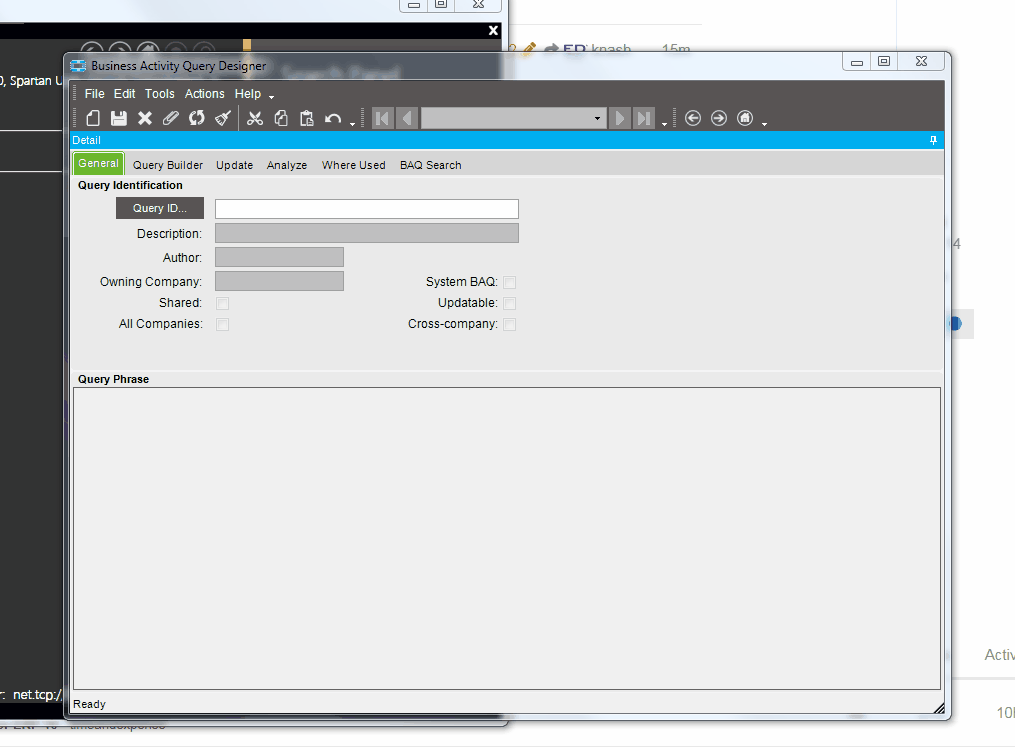

Here is what I see.
deleted BAQ.
Load the form. got an error, which is expected.

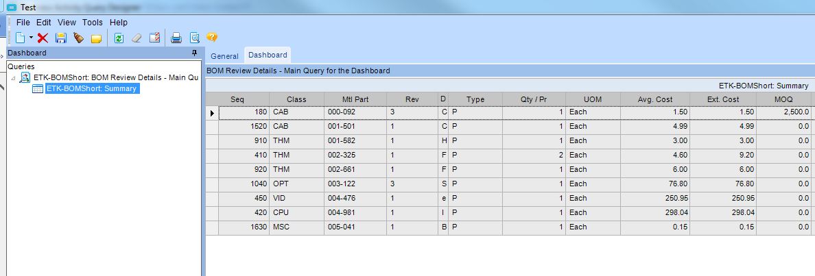

added baq back.
Now BAQ is returning all of the records. crazy
Thanks for the idea of backing up and deleting.
Awesome! Must have gotten corrupt. Never had that happen.
