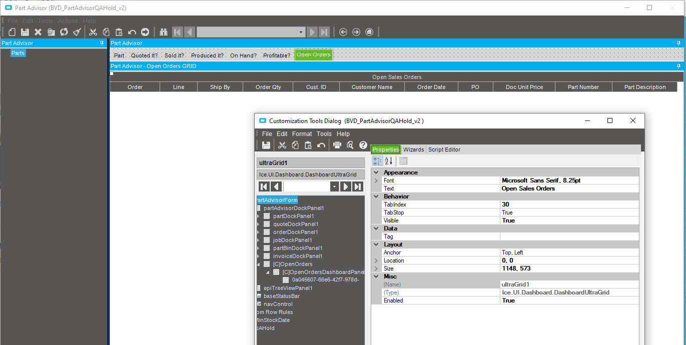

I’ve got a BAQ DataView bound to a grid on the Part Advisor form. Works well, and highlights some conditions too. I’ve added another column to the underlying BAQ, but it isn’t showing up in the grid. You can’t select the columns either.
