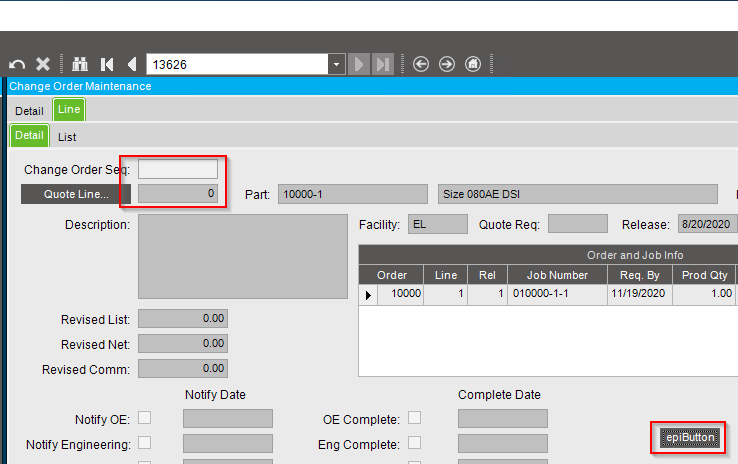

Update:
I was able to monkey with the publish/subscribe code to make the baq dataviews display the correct code for the record loaded, but when the form clears or (on a child record) there is no record, the last data in the baq dataview hangs around.
Here is a modified UD106A screen:
This parent record has no child line (no UD106A to subscribe to). The data shown here is hanging around from the first parent record in the list, which did have a child line.
Notice the button. It runs the following code:
	private void refreshBAQDataView(BAQDataView bdv)
	    MethodInfo mi = bdv.GetType().GetMethod("invokeExecute", BindingFlags.Instance | BindingFlags.NonPublic);
	    mi.Invoke(bdv, new object[]{ true });
	private void epiButtonC1_Click(object sender, System.EventArgs args)
		refreshBAQDataView(_edvBAQPartDisplay);
When I click the button “Retrieving Data…” briefly flashes in the status bar, but the old data either remains or is reloaded from the original record.
I’d gladly take a hint. :slight_smile:
Thanks,
Joe
