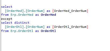

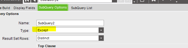

@ahsalloum Use the EXCEPT operator in the BAQ. Try it like this:
Use OrderHed in your top-level, and OrderDtl in the subquery, and set the subquery as Except:

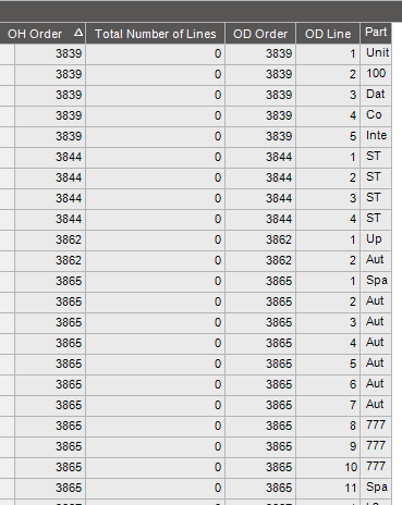

@Hogardy @ahsalloum I was also unaware of the TotalLines column, but when I queried that and joined with OrderDtl, I got some interesting results…
YMMV
