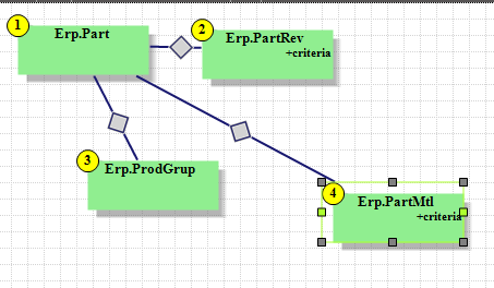

Hi,
I am trying to create a BAQ with list of the first material (10) on all parts BOM’s. And the active Revs. I thought i did everything right but i am getting duplicates some triple part #'s that are listed. the rev’s are the same but it is listed twice
Try connecting your PartMtl to PartRev. When you do, it will automatically add some relation fields. Make sure to remove the AltMethod, and ProcessMfgID relations. They don’t work.
That worked. Thank you so much!
