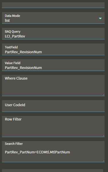

I have attempted both row and search filter
e.g PartRev_PartNum=??{ECOMtl.MtlPartNum}, PartRev_PartNum=‘{ECOMtl.MtlPartNum}’ etc.
In all cases I have attempted, I have either retrieved the entire BAQ data or no data at all.

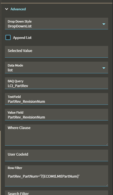

I would try PartRev_PartNum='?{ECOMtl.MtlPartNum}'
Gave this a try - still not correct I believe.

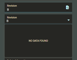

Some more information:
tested and verified ECOMtl.MtlPartNum is actually on an expected value:
rev drop down I am creating still shows ‘no data found’
(That default ‘B’ revision I am manually setting to the EP Binding when you come to this page. Same EP Binding as my other text field above)
BAQ returns values that PartRev_Part should match with ECOMtl.MtlPartNum:

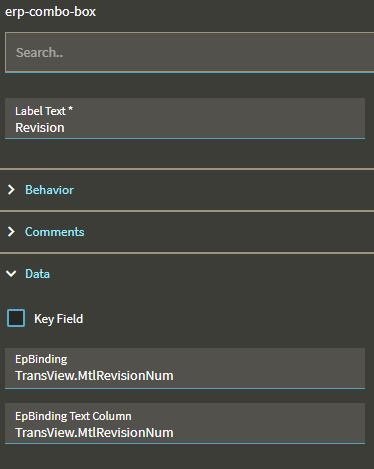

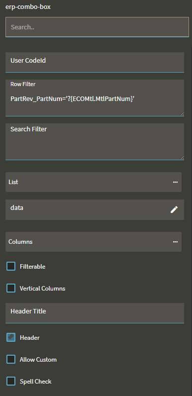

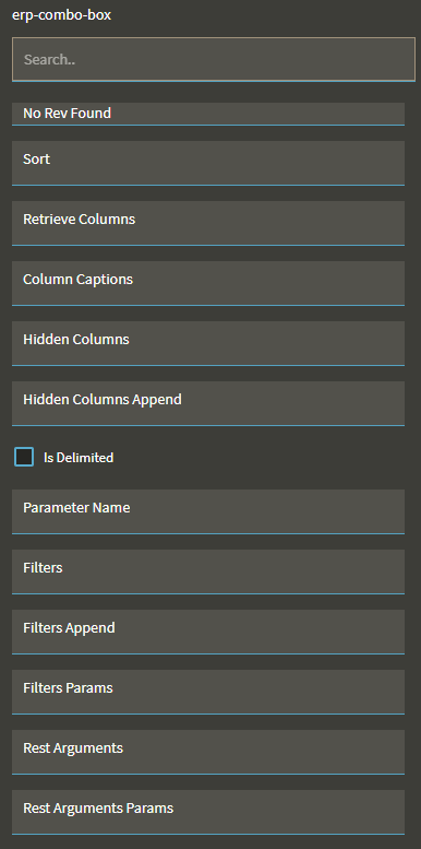

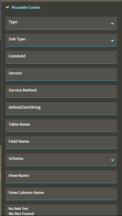

Here is my FULL combo box properties:
Not sure why I am struggling with this and I always feel close to a breakthrough :smiley:
ended up getting combo working by populating a dataview with the BAQ - I passed BAQ params in event that populates the dataview. Then, combo simply works off the dataview. A little run-around and I would still like to figure out these filters for using a BAQ directly however this works.
