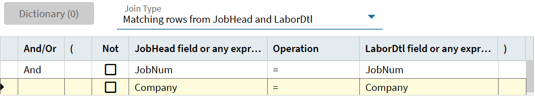

In BAQ Designer (Cloud version), if I join two tables which do not have an index or automatic entry for Matching rows in Table Relations, I add them manually, starting with Company then find a common field such as JobNum etc which shows as an “And”.
Then I add fields into my query to get a set of results.
The issue is, when I come back to my BAQ to look at again, I hit the Test button and I get the error “Severity Error, Text:Bad SQL statement” which has been caused by the 2 fields swapping places causing the “And” to jump to the top and spoiling the logic. I reverse it to fix and can then run my Test.
