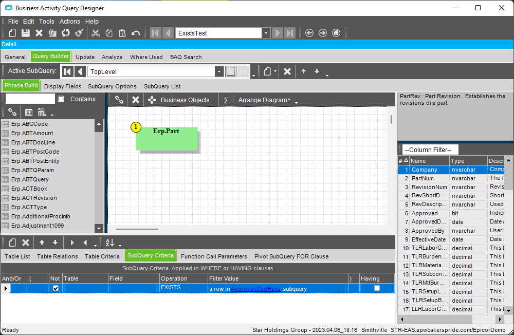

I may be wrong but you need to add correlation between subqueries. the criteria you have here:
you need to go to the second subquery (PR) and add Where clause there that point to the first subquery (P)
Ahhh, now I see how to do it! I didn’t know you could specify a column from a different subquery in the SubQuery Criteria. Thank you @Olga!
Here’s some screenshot for reference:
This gives this query in the General tab:
select
	[Part].[PartNum] as [Part_PartNum],
	[Part].[PartDescription] as [Part_PartDescription]
from Erp.Part as Part
where (not exists (select
	[PartRev].[Company] as [PartRev_Company],
	[PartRev].[PartNum] as [PartRev_PartNum],
	[PartRev].[RevisionNum] as [PartRev_RevisionNum]
from Erp.PartRev as PartRev
where (PartRev.Approved = 1)
 and (PartRev.Company = Part.Company  and PartRev.PartNum = Part.PartNum)
