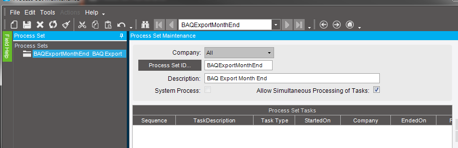

First, set up a new Process Set:

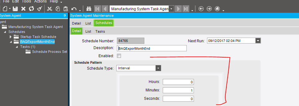

Second, create a new schedule on System Agent:
There are many schedule configurations but I did this at one minute just to verify it works.

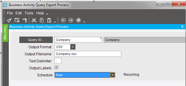

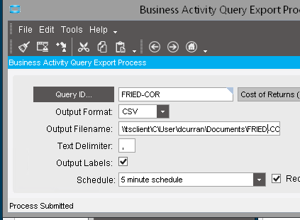

Third, go to BAQ Export process and attach it to that schedule
Output labels creates header labels.

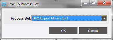

If you save this to a process set (second tool icon), you can attach to your schedule

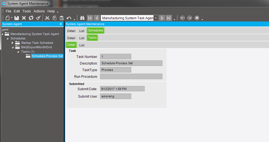

If you go back to your Process Set, you can see there is an attached task on it now.
Fourth, go to Schedule Process Set and hit submit to schedule this bad boy
You can verify it go scheduled by going back to the system agent and seeing the task there now.

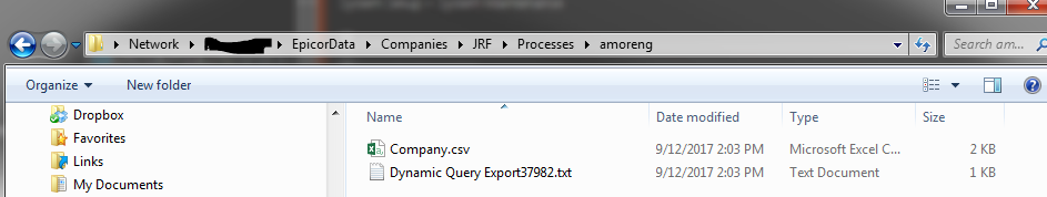

The query results, at least with our configuration are located on the application sever under \servername\EpicorData\Companies\ {currentCompany}\Processes\ {userWhoSubmitted}
Do you know how to define a different output folder location for the results?
You define it in the Output Filename.
Can you elaborate on that? I defined it with a file name “Company.csv” but it places the actual file in a directory that is inconvenient. I’m trying to figure out how to configure which directory it goes to.
Put the path you want the export to go to with the filename.
\\server\share\share\file.txt

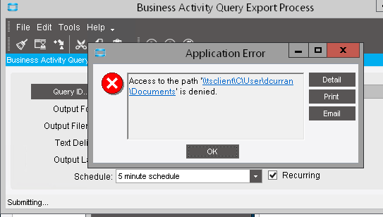

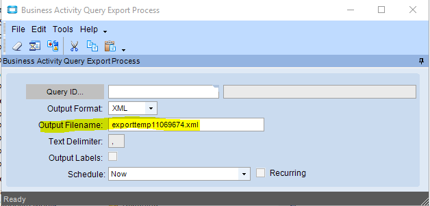

Does anyone know how to specify file path for hosted environments?
I tried this but I get an error.

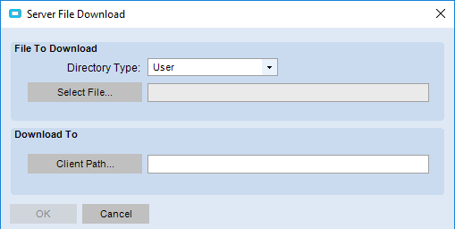

Just give it a filename then use the File Server Download program to grab your file.
It should be under your user name if I recall correctly.
The reason they do that is you really don’t to give arbitrary Azure sites write access to your servers now, do you? :wink:
