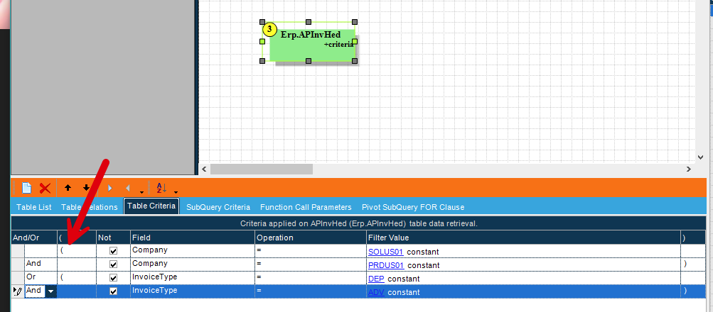

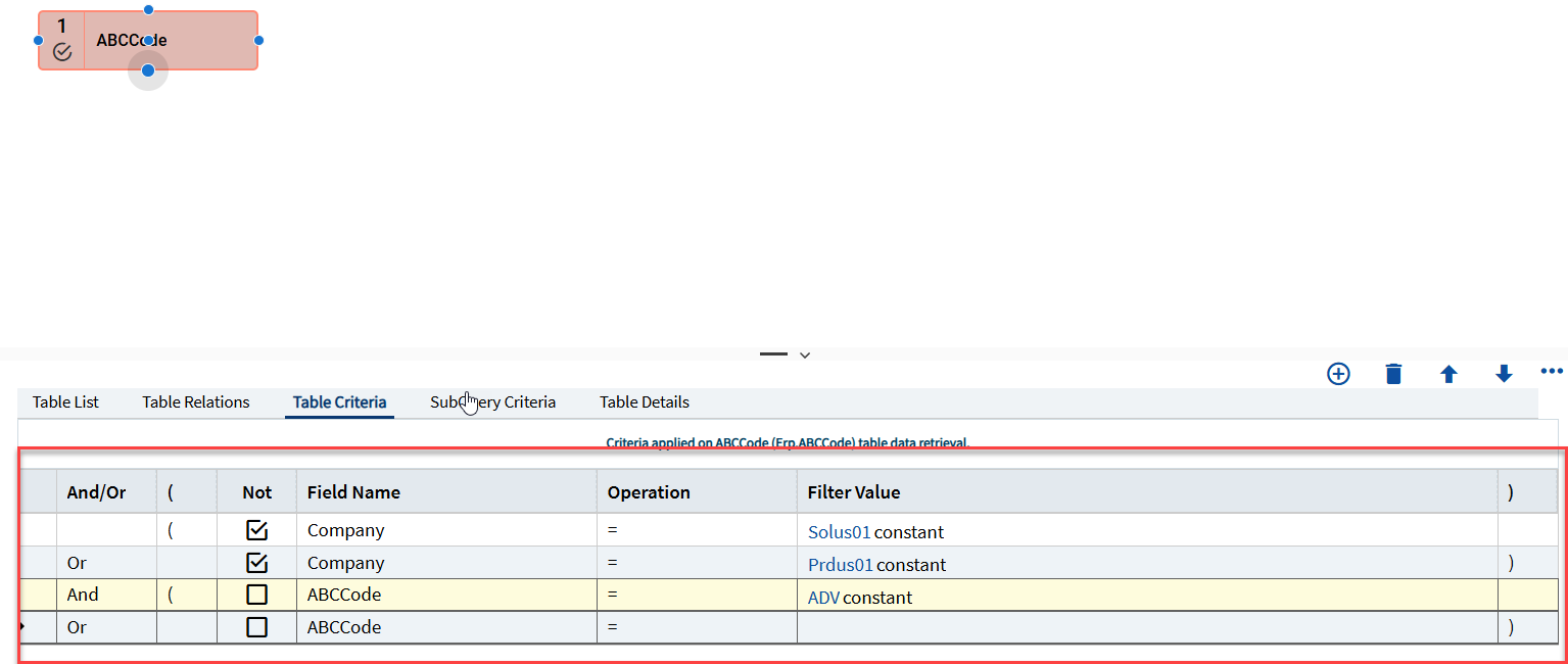

Something like this:

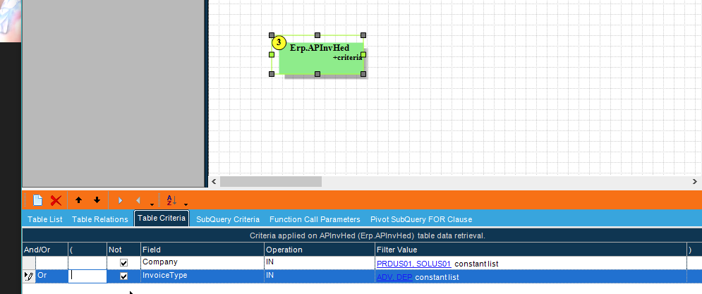

Or you can use lists, just just check the not box.
If you want to do explicit lines, you can do it this way.
It’s all just a logic puzzle really.
Oh I think I didn’t make myself very clear, I want it to pull all 5 companies in my list of companies, and filter out those types of records only for two of them, but still pull all other invoice types for those two companies
That’s exactly what this does. (there is an “Or” function, and “not” checkbox is checked)
If the company is not PRDUS01 or SOLUS01, then include it.
if they are PRDUS01 or SOLUS01 then include everything that’s not ADV or DEP.
Step through the logic.
You could do it the other way around to and say if they are the other company, then include everything, and otherwise only include things that are not ADV or DEP.
