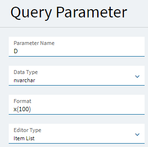

I have a parameter ‘D’ that is a Item List (nvarchar x100)

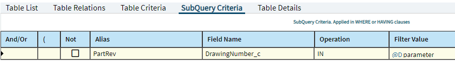

I am trying to see if the custom column DrawingNumber_C (nvarchar x100)
is IN the parameter 'D’s list.
I pass in multiple drawing numbers and expect to get all the matching results back.
If I pass in drawing numbers that are 50 characters or less it all works as intended. As soon as I pass in a drawing number that is > 50 characters it fails.
with an unhelpful error message: "Severity: Error, Text: Bad SQL statement. Review the server event logs for details. "

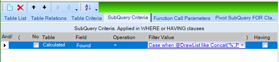

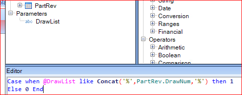

I did a test using a case statement to check the filter param.
I made a calculated field called Found bit with a value of 1
Then made this expression to look for the DrawNum in the DrawList and return 1 if found
Case when @DrawList like Concat('%',PartRev.DrawNum,'%') then 1 Else 0 End
it returned good data with a space separated list of 6 drawnums.

Did you create a new parameter @DrawList that was not a list type and just dumped all the drawing numbers in one value?
Yes, DrawList was just a varchar 1000 space delimited parameter. You should see D in your Parameters.
