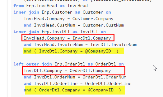

Also… What is the point of these parameters (the highlighted parts) for the company?
InvcDtl.Company, must be the same as the InvcHead.Company, but then you also test InvcDt.Company against a parameter.
Are you trying to pull info from multiple companies?

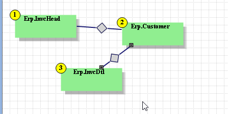

One thing I notice when trying to build a similar BAQ, is that the automatic links that the BAQ designer makes when you drop a new table in, prefer to link Customer to InvcDtl.
If I start with InvcHead and add Customer, it makes the expected relationships. Then when I add InvcDtl, it makes relationships between Customer and InvcDtl.
If I start with InvcHead and add InvcDtl, it makes the expected relationships. Then when I add Customer, it makes relationships between InvcDtl and Customer.
Is this because of some prefered join between InvcDtl and Customer? Or is it just because a newly added table always tries to join to last table table (i.e. 2 -> 3 regardless of the tables - assuming a relationship exists)?
The newly added table always tries to join to the last table number.
