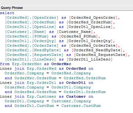

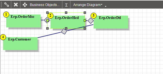

I am new to building BAQ’s and trying to make a BAQ to display open orders but am not getting all of them. What do I need to edit or build to show all open orders?

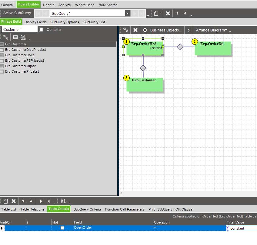

I would link it the following way. With a criteria on your OrderHed table being OpenOrder = Specified Constant being “1” to signify true. This alone will give you what you need for open orders since it doesnt seem like you are using the OrderMsc table for anything.
If you want to limit the date range you can either do it by adding more criteria or if you want it to be adjustable by creating parameters to be entered in at the time of execution.
This will show you a result for each line item as well for each order since you are using the OrderDtl table.

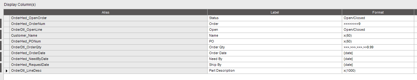

Question , how do you know what to input in the specified constant ?
Such as you notated , 1: true
What others numbers can you input and there meaning?
In the case of OpenOrder if you look at it in the Display Fields tab you notice it says “Open/Closed” under format and if you look on Phrase Build on the right its type is “bit”. This basically means its either a true or false statement so 1 for true or 0 for false.
