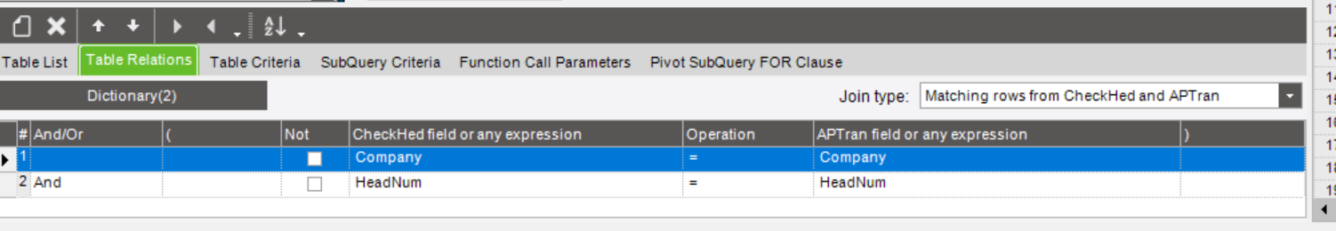

Whats the best way to link these if the “Related To” field between APTran and CheckHDR is not the same?

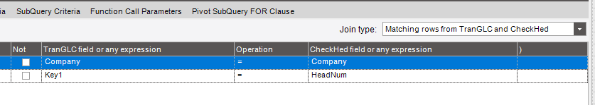

I tried to join based on key and it just says bad SQL.
Thank you!

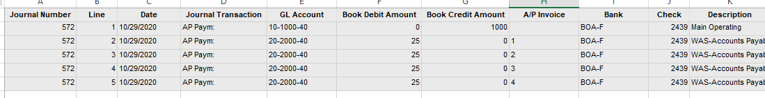

Thanks - Getting closer. what if I want to see both the debits and credits though of the journal though?
if I only use CheckHDR I just see the credit.

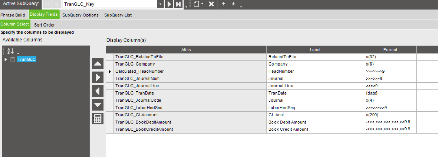

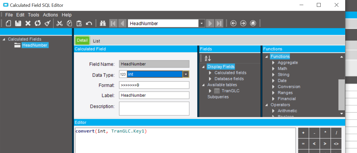

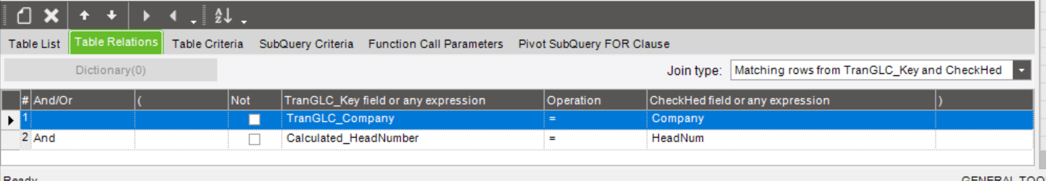

The Key in Tranglc is a string and thus would need to an integer first. I create that as a innerquery first.
convert(int, TranGLC.Key1)
From there join the calculated field to the headnum from checkhead
If you need an example let me know

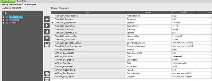

Try this out

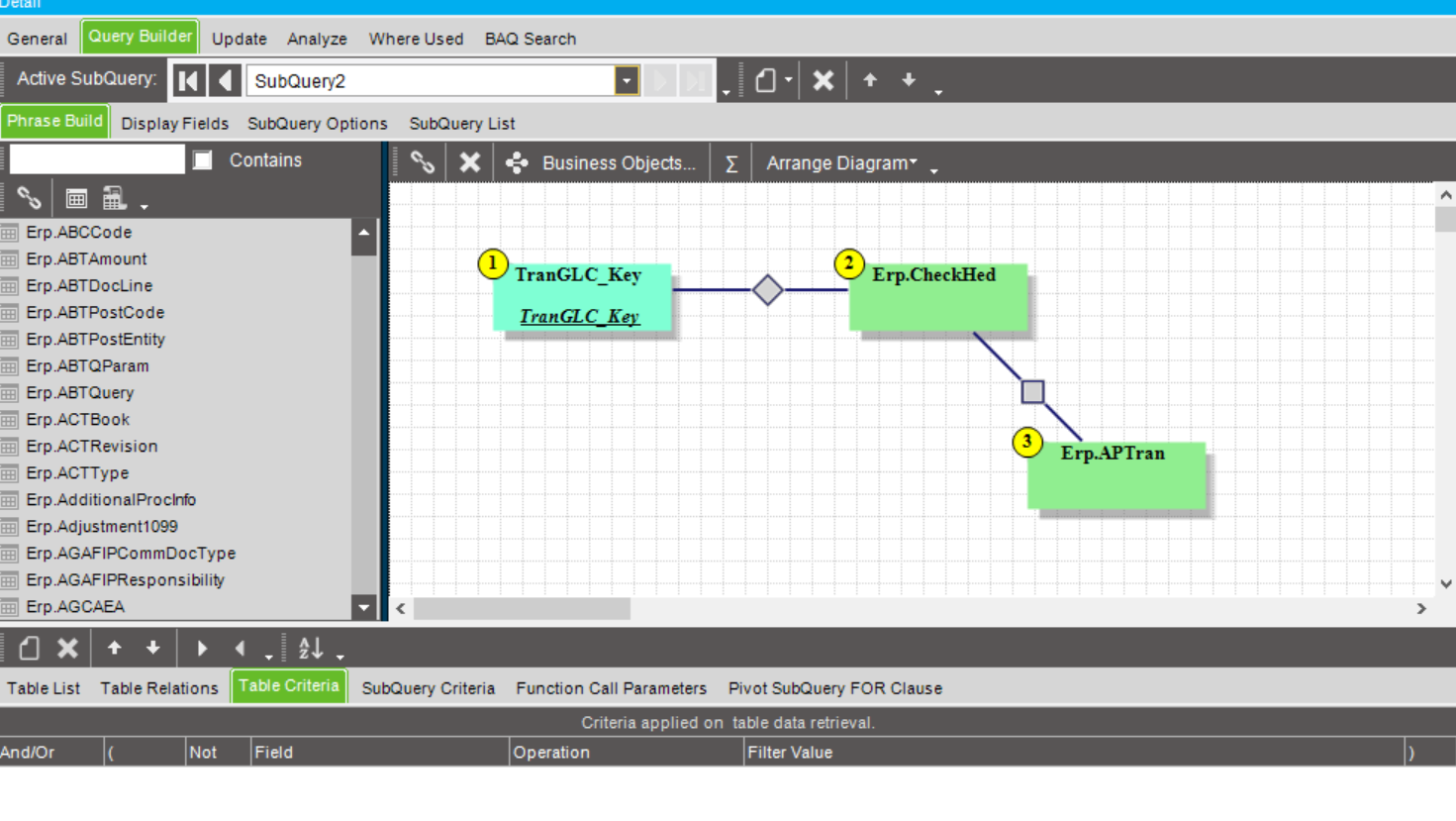

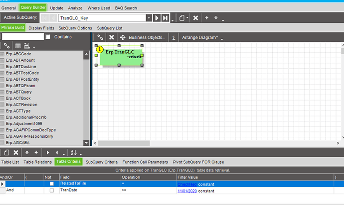

create a filter query (how I like to do it btw)

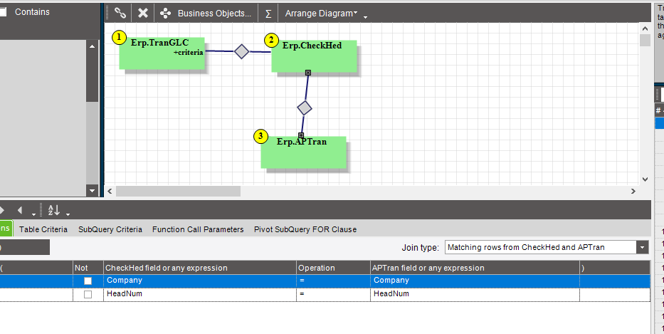

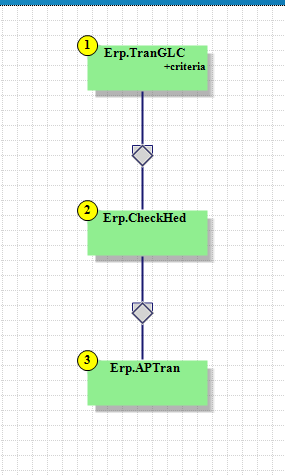

Then create your report as such

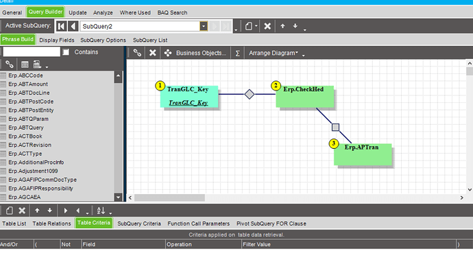

Relationship from TranGLC_Key to ERP.CheckHead
Relationship from ERP.CheckHead to ERP.APTran

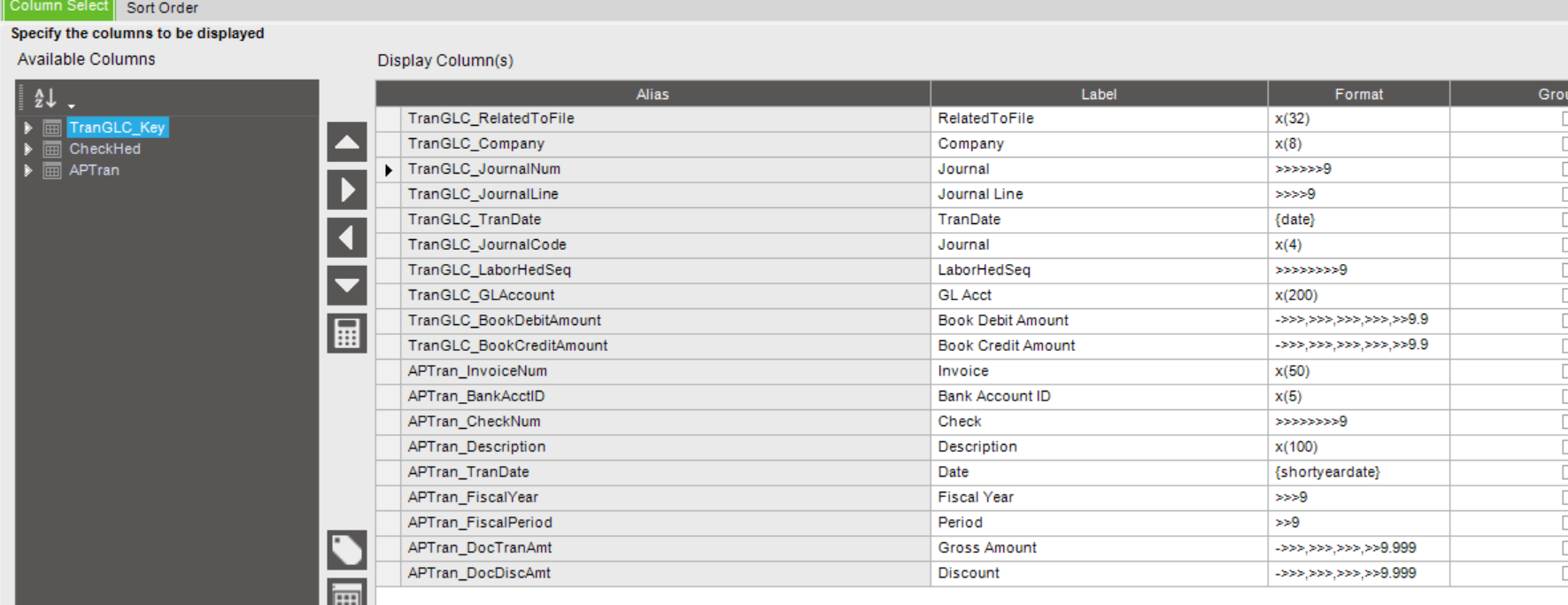

Display any fields you want at that point - in my example I have the following
Hope this helps
Peter
In the TranGLC_Key is where I have the formula to convert the string headnum to an integer for the record.

How do you get from screenshot 1 to screenshot 2? I know who to create a subquery and the calculated field, I’m just not sure how to connect subquery 1 and 2 together via that new calculated field?
In the designer instead of adding a table (first icon) add the subquery (second icon) and manually add the join (in this case company and headernum)
If you download and install the BAQ I included you should have what you need (as a framework)
