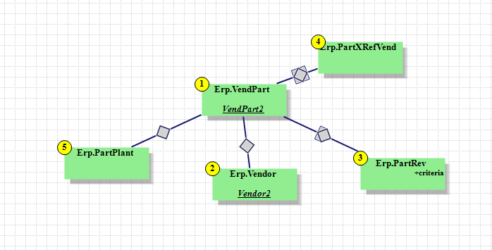

I’m attempting to write a BAQ or Dashboard to display part numbers with their suppliers, that do not have the best price selected for the Primary Vendor. So far, I have been able to retrieve the latest price record for each possible vendor.
I’m not sure how I can display this so only the parts that we pay too much for are shown or highlighted somehow. A > B type of thing.

so you’re looking for either the Min() base unit price per Partnum?
You could use a calculated field for Min(), grouped by your other columns. I would do that in the subquery and include the basic fields you need to join to the top level query. And include the “primary” column, then filter out (subquery criteria) where “Primary” = 1 on the top level query
The result set should be parts and suppliers that are the best ( Min() ) price but not set as primary.
Without writing the BAQ, I’m pretty sure that would work.

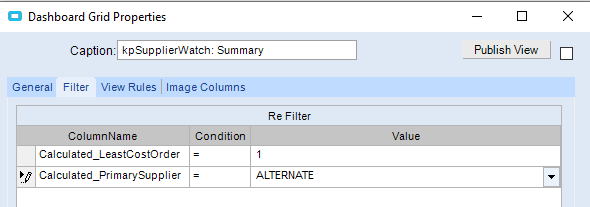

ROW_NUMBER() OVER(PARTITION BY Part.PartNum ORDER BY VendPart1.BaseUnitPrice ASC)
Dumped it into a dashboard to do some more filtering
Result is what I need, list all parts where there is a better price with an alternate supplier.

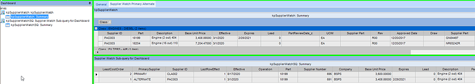

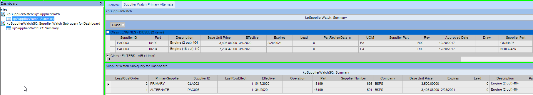

Would you know how to make this dashboard pass a part number from the first query when clicked to the bottom query? I setup two seperate BAQ. My goal is that the bottom list will display all the price records for the highlighted part.
Tracker does it for one row but almost need it to execute a BAQ for the row thats clicked, then display.

You’ll need to right click on the top query and look at “Publish”, then do the same on the bottom query but look at “Subscribe”. :slight_smile: This is a super powerful way to associate queries on a dashboard. we use the heck out of this feature so we don’t have a zillion dashboards.
You nailed it! Thanks again!
