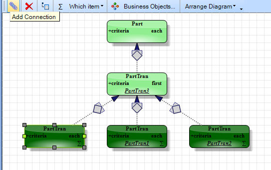

Still fighting with ā€˜Cut off Date’ . Criteria / parameter in BAQ, Date Range filter in Tracker view not working. Tried all available tricks…but still BAQ is incomplete without ā€˜Cut off date’…
I think , i have used 4 instatnces in BAQ ,screenshot is attached. Is it the problematic ? If i had not used,then i cant apply crieteria for 3 instances at a time.
Anybody has any suggestions ? please share…
Have you tried adding the CutOff data as a criteria on all 4 PartTran tables/aliases and having the those 4 criteria reference a single mandatory BAQ parameter.
When the BAQ is called from the dashboard it will automatically call popup the cutoff date which will also make sure they query isn’t run wide open.
