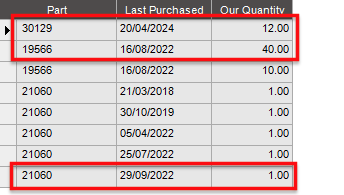

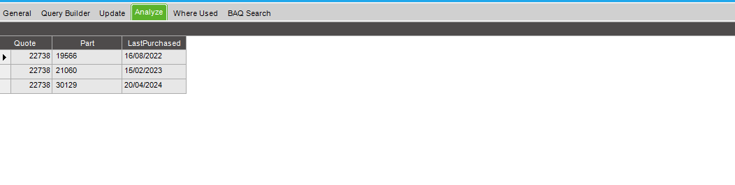

Im trying to get the recent date of the part purchased along with the quantity. Im able to get the recent date of the part purchased but when i add the quantity in the Display column in BAQ i do not get the exact data as expacted. Expected Data should be 3 rows but im getting 13 rows after adding quantity. I have attached the images for reference

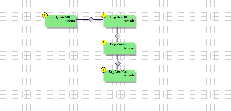

I tried using innerSubQuery to calculate the max(RcvDtl.field_name) and then linked with Top level query using Subquery criteria. Im getting only single row in return. When i added quantity field in the innerSubQuery again and group it i get 8 rows in return. I can understand why its happening but not getting solution to get the exact 3 rows.
I have added a screenshot and highlighted the field which i actually want
Screenshot 2024-05-02 at 5.23.31 PM
Screenshot 2024-05-02 at 5.24.58 PM

Thank you, but there is something missing here or this is not the right query. Also, please refer to this post Code Syntax Highlighting in Posts when providing code like output.
From just a cursory glance you are not isolating your result set with this:
Should be looking for and saving the last date for the part num to link back to the part number result based on the query you provided.
Yes i was missing to link back to the part number.
