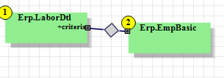

My goal is to make a BAQ to show only employess who’ve had labor activity in the last X days
I am using LaborDtl to filter the createdate then trying to link that to EmpBasic to get the name.
It’s effective but I’d prefer to not have loads of duplicate names on the result list. I’ve tried to finagle it with join types and even played with a subquery (which I have no experience with) to no avail.

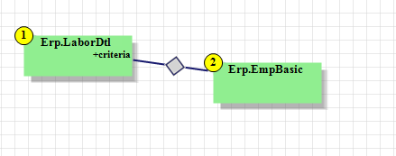

ok you twisted my arm…here is my take… (no need for subqueries if you use group by… not to say subqueries are wrong… but there are many ways to skin a cat)
LaborActivityThing.baq (16.1 KB)
Add LaborDtl and link it to EmpBasic
Filter the LaborDtl by a Param for Number of days… so you can say Give me Employees with Activity in the last X days
Then simply display the fields you want and group by them (to eliminated duplicates)
Then use a calculated field (for the heck of it) to show you how many LaborDtl Entries they created in the given period
The result is just the Employee Name and Info with a Count of Labor Transactinos
MIne is not filtering all duplicates:
Becasue your Create Date is different for Each Employee …
Group By Groups by the Common Fields.
