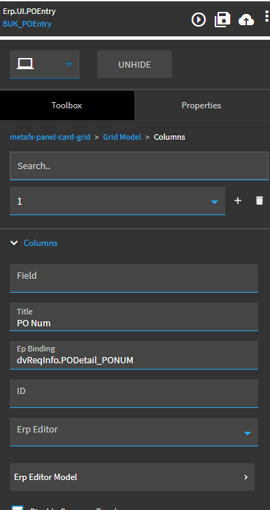

Been following this topic and it’s been great at getting the BAQ data to load correctly but it’s bringing all columns through even though I’ve specified them - they look correct in design but when I preview the form it brings all the columns. Can anyone advise what I’m missing or if I need to design a specific BAQ with only those columns?

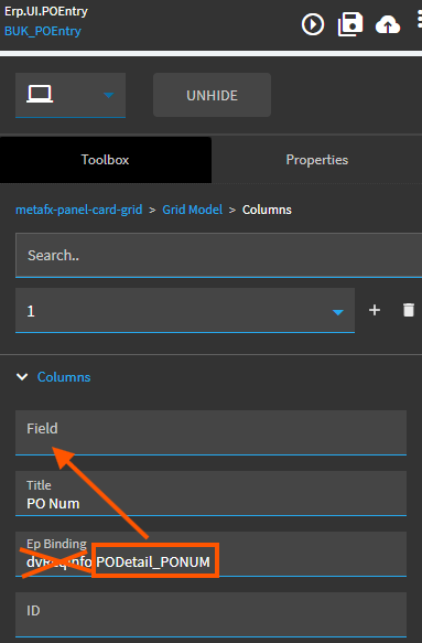

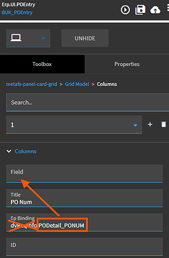

You generally don’t need an Ep Binding on grid columns… but you DO need to fill in the Field. I would trying adjusting your settings as follows:

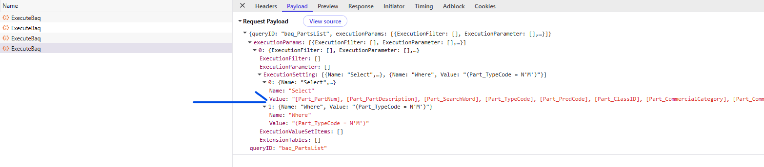

From what I can tell, the ExecuteBaq builds a select list from gridModel.columns
And Personalize doesn’t show columns removed from gridModel.columns.
So it should be fairly secure as far as the data not coming over the wire and users cannot add columns you don’t have in the grid.
