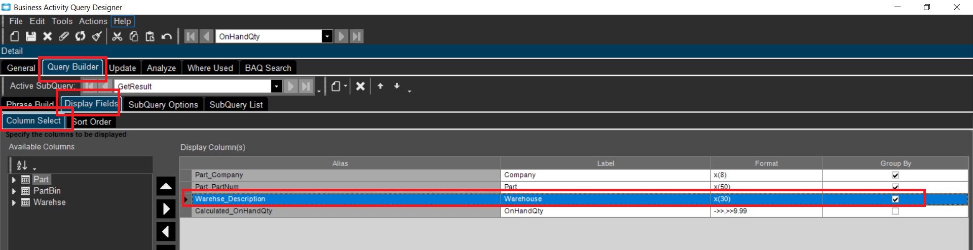

so what i did was took your BAQ and then added the warehouse field with a sub query of selecting which fields I want so the three above what do i do then as it says the warehouse field either needs to be a group by or a aggravated comand
Navigate to Query Builder > Display Fields > Column Select. In the Display Columns(4) select the Group By checkbox for warehouse code column.

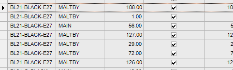

okay cool so now it only pulls in stock levels from those three main warehouses however is there a way it can still group the on hand stock together by sku from the values in those three warehouses

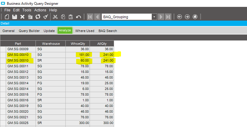

@pompe4040 attached is the BAQ as you’re requesting it. Note, since you’re wanting Warehouse qty and All Qty, the “All Qty” is going to get duplicated every time the part exists in multiple warehouses. I removed Company from the screenshot as I didn’t want to list it but its on the BAQ.
The way it was added was via Subquery, try reverse engineer the attached BAQ for learning purposes. BAQ_Grouping.baq (28.3 KB)
Because you have different Warehouse so it groups by Part and Warehouse. If you want to group by Part only, remove column Warehouse. In case you can pull only PartBin table, no need Warehse table.
