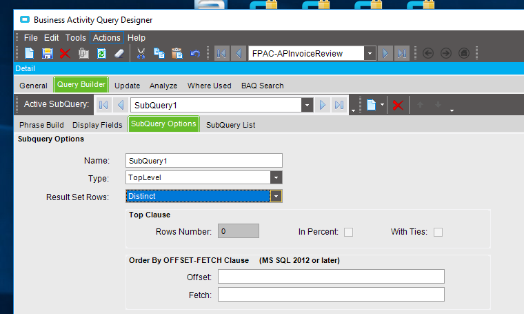

I am trying to do a simple BAQ on AP Invoices and a post date; at least I would have thought this was simple
The Post Date is only in the GLJrnDtl and since it has a Debit and Credit entry it is giving me both. I have tired various ways to narrow it down.
This is what I have now and it shows both lines for each group. I do have the Query options set to Distinct
One question is I added a GroupID on the Table Relations and fixed my duplication but it removed the other group…Why??
Put a table criteria on GLJrnDtl to only select records where CreditAmount <>0. That should eleiminate all the Debit records, leaving you “half” of each GL tran
Thank you…that did it. I had tired with the Debit Amount >0 but it didn’t work. Thanks you :grinning:
