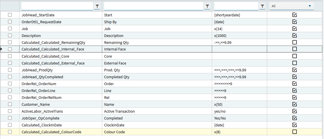

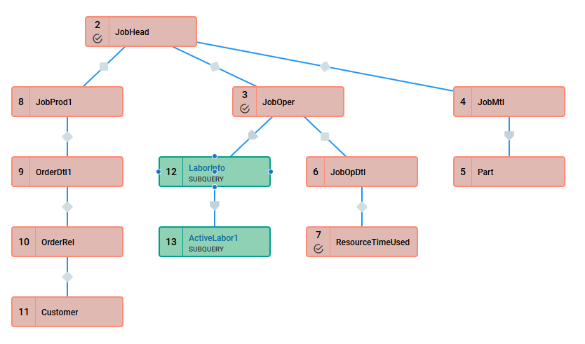

my overall BAQ now looks like this:

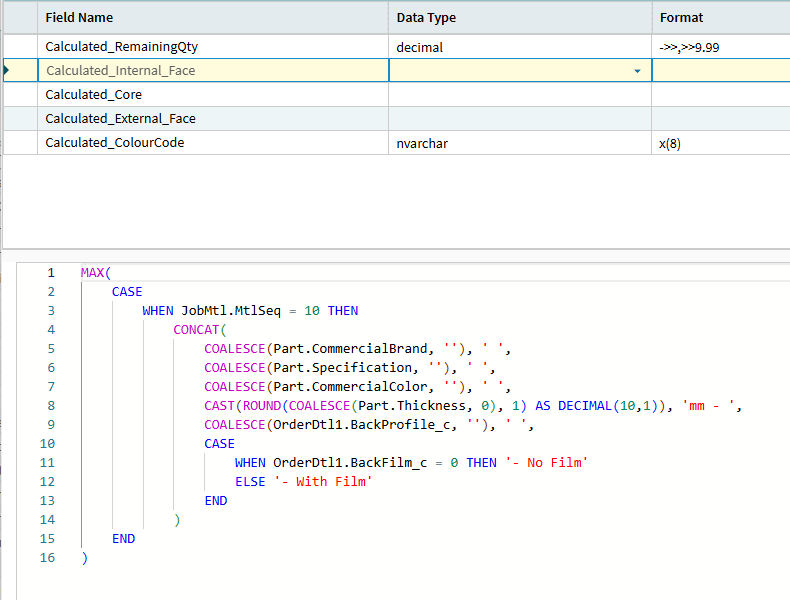

the calculated fields to allow to ‘group’ the job materials in one line looks as follows:

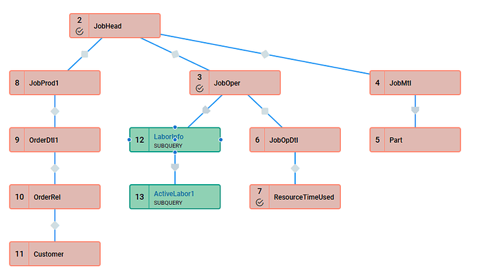

and then simply using the group-by makes the BAQ work:
