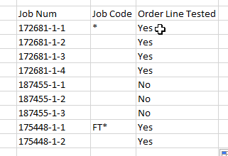

I have a requirement to gather all Jobs in a BAQ and check if the group of jobs had any testing applied to it per Sales order line.
Our Job number appears like following
172681-1-1
172681-1-2
172681-1-3
Its made up of First 6 characters refer to the sales order number, the next 2 characters are the sales order line, and then following 2 are the Sales Order release
I need to check each group of jobs which are all related to the same Sales order line and if all the Jobs ‘Job Code’ field do not contains a * then display the Sales Order Line as Not tested.
So in example below
Id like my baq to produce:

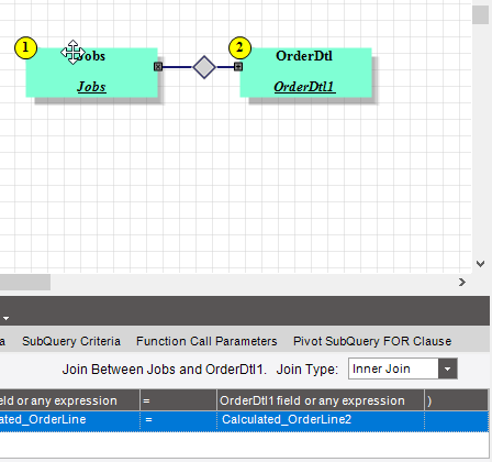

I have made 2 subqueries -
Jobs - one to collect all jobs where Job code doesnt contain a * and grouped by Sales Order Line (calculated trimmed field from job num)
OrderDtl to collect all Order lines where Max test days > 3 and grouped by Sales Order Line (calculated field convert(varchar, OrderDtl.OrderNum) + ‘-’ + convert(varchar,OrderDtl.OrderLine)) to build the Sales Order Line
Then I have joined both subqueries together by the calculated Sales Order Lines
Problem is im seeing Sales Order lines where the jobs did have a *
What do you have on your Jobs query? You can create a sum field and use a case when clause inside that .
Sum ( case when JobCode like ‘%*%’ then 1 else 0 end) and on the top level query set your where clause to filter base on the calculated field equals to zero. Also I think if you use JobProd to link jobs to the order detail will be much faster than a calculated field, then you can link JobProd to JobHead.
Thankyou Jaime this worked perfectly.
