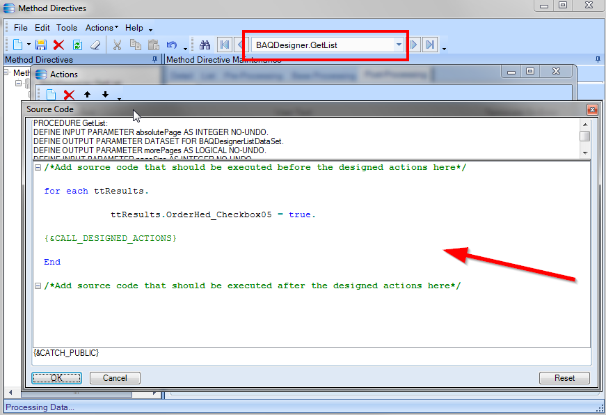

In Advanced BPM processing do this abl code in Postprocessing of the getlist mark the order as processed. Then exclude that checkbox in the criteria, so they won’t show in the next run.
for each ttResults.
            ttResults.OrderHed_CheckboxXX = true.
End

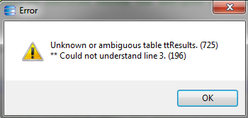

Thanks for the help. When I do this it is giving me an error. What am I doing wrong? I chose BAQDesigner.GetList

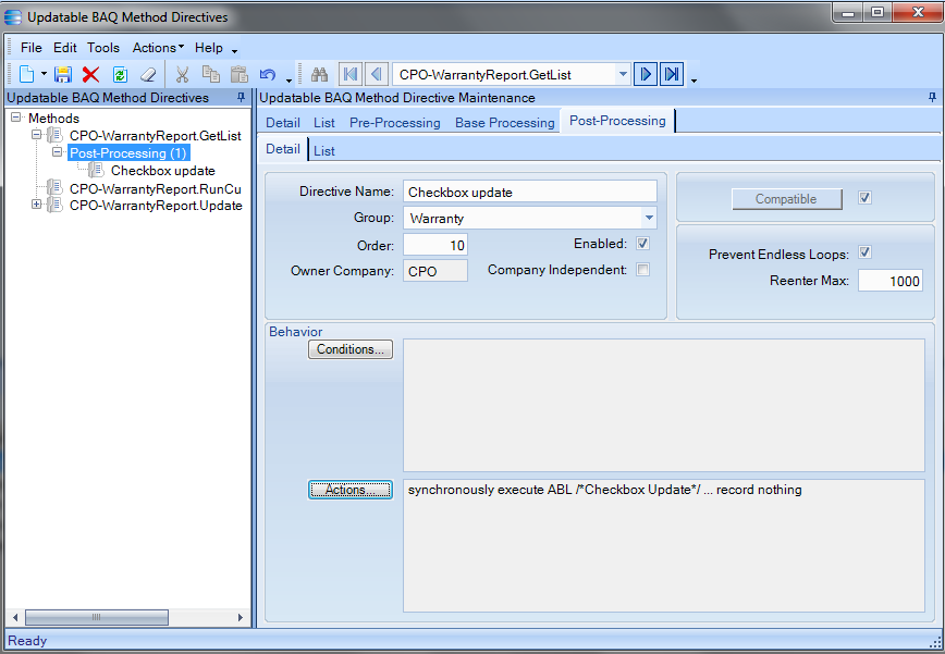

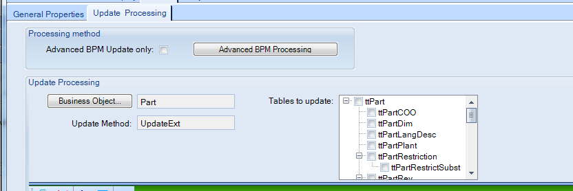

This is done in the BAQ Designer. Make the BAQ updatable, and set your checkbox as updatable. Click Regenerate BPM Directive.
Click on Advanced BPM processing and add the routine as post processing under GetList. Pick ABL code and put the routine there.
When getlist is clicked ( refresh in a dashboard ) the bpm will run.

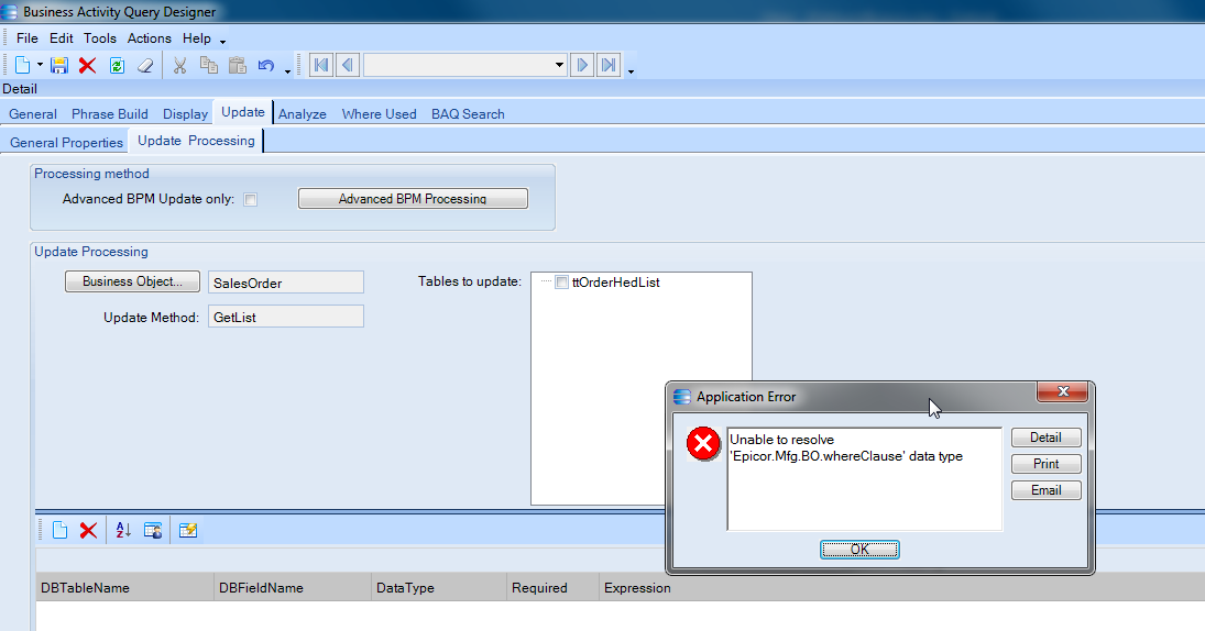

Hey Greg,

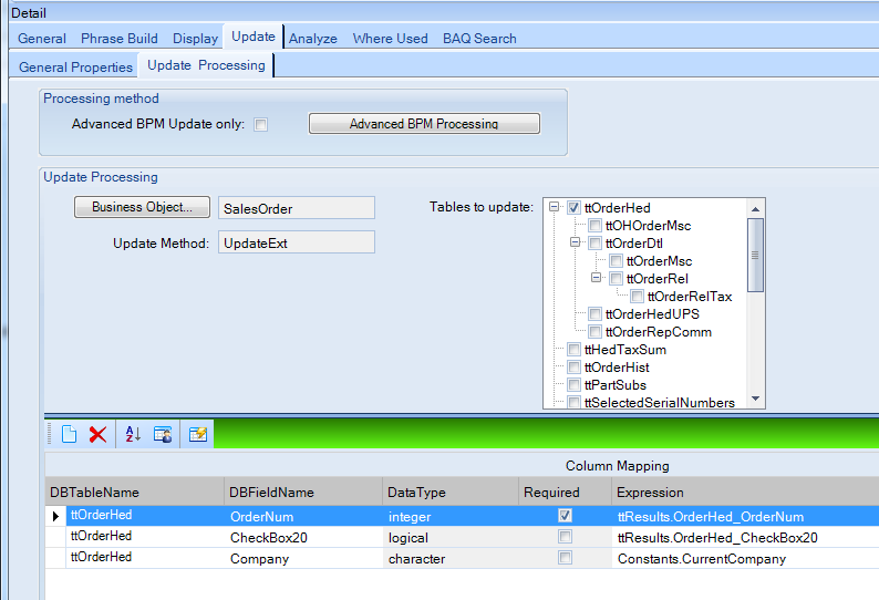

I am getting this error when I click on Regenerate BPM Directive. I have deploy the Dashboard, but the orders are showing up each time it runs so the BPM is obviously not working.
Your update tab should look like below. UpdateExt is the normal update method. Just check ttOrderHed.
As I made the example I realized that someone would have to save the results to update the order and not just the dashboard.

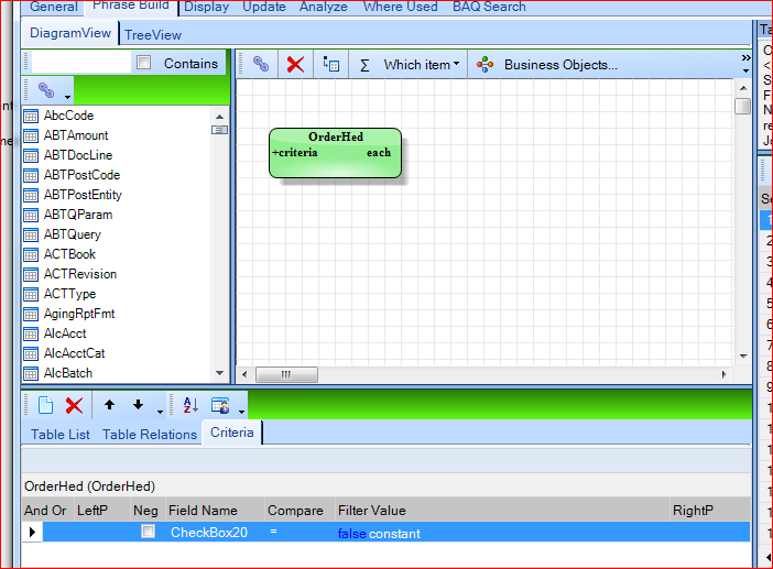

Are you checking for the checkbox to be false in the criteria? Do you have the checkbox in the results to see if it has been set?
Greg
[cid:image001.png@01D2355C.301FA7D0]
Call me a moron. Man, I really appreciate the help on this. This is going to completely cut out any manual (human) interaction now for my project. Thanks again!
