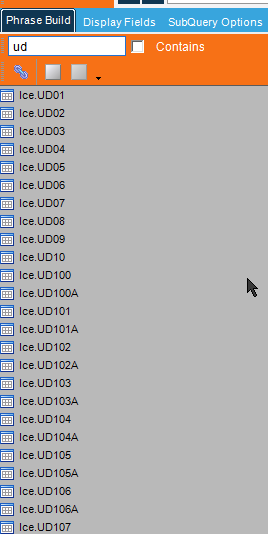

I have seen ‘UD’ as part of a field name, but otherwise clueless.

No, you’ll see those in a normal Epicor BAQ. Search “UD” and you’ll see them all.
