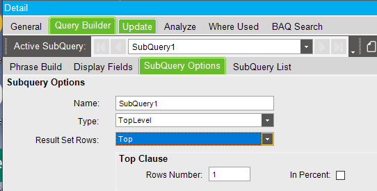

I am still running into issues. If I use the Top function, then I only return one row of data. I thought I needed to separate it all out into independent sub-queries, but that is still not working. Any ideas how to get this to work?
Here is what I have. I have made 2 sub-queries and a top level query, as shown below.

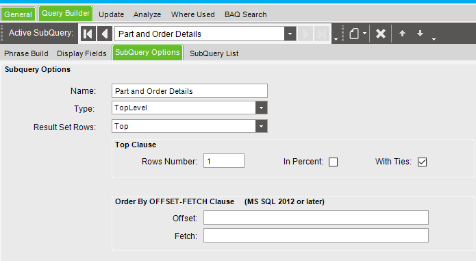

I have tried to use the “Top” and “Distinct Top” on both the ‘Order Details’ sub-query and the top query. When applied to the Sub-query ‘Order Details’ it returns only 1 row. When applied to the ‘Part and Order Detail’ top query, it returns 0 rows.

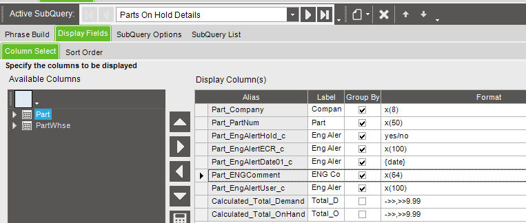

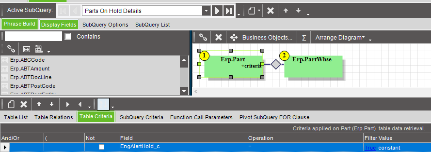

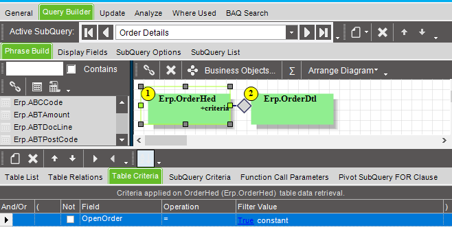

Sub-Query 1.) Parts on Hold Details

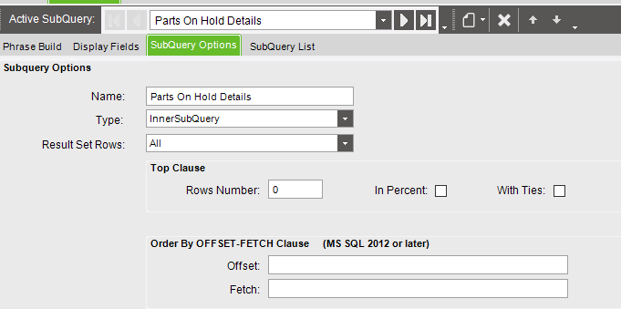

SubQuery Options:
Phase Build:
Display Fields:

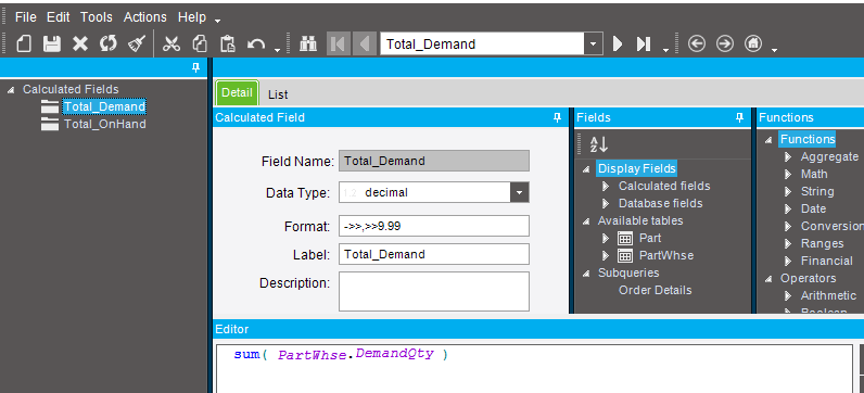

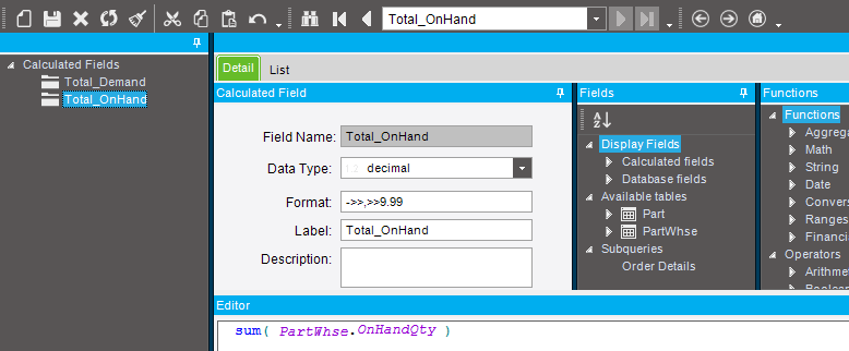

Calculated Fields:
Total Demand
On-Hand Qty

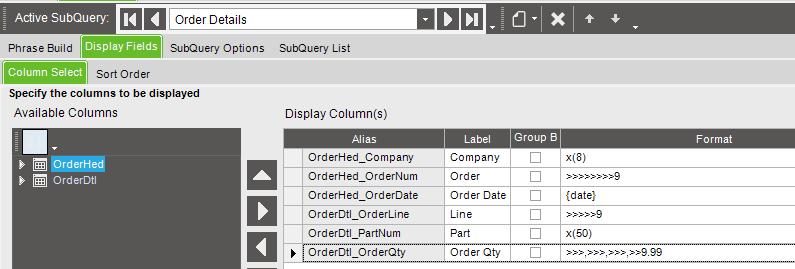

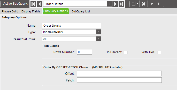

Sub-Query 2.) Order Details
SubQuery Options:
Phase Build:
Display Fields:

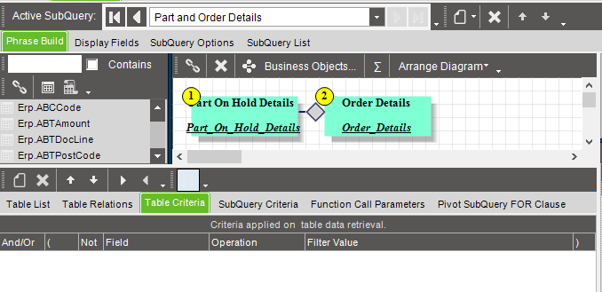

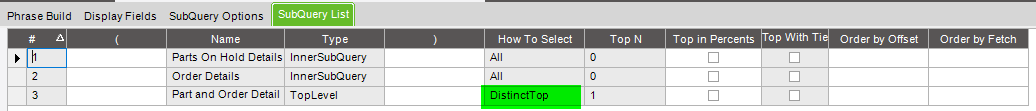

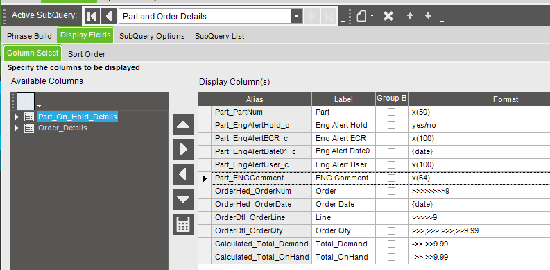

Top Query 3.) Part and Order Details
SubQuery Options:
I have tried with Ties and without. Also Top and Distinct top.
Phase Build:
Display Fields:

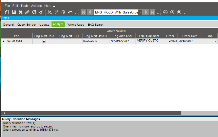

Everything I have tried, only returns this one row…
Please help me figure out what I am doing wrong… If you need more information, please let me know. I am happy to supply it.

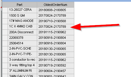

You might have to combine the date and Ordernumber into a string so you first have something like:
Then on another subquery, select the MIN(OrdeDateNum) to get the oldest order order for that part
Then another level of sub-query to extract the Ordenum from the OrderDateNum string

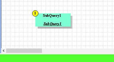

SubQuery1 (InnerSubQry)
Table Criteria: OrderDtl.OpenLine = 1

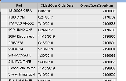

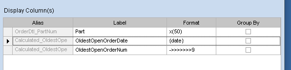

SubQuery3 (TopLevel)
Display Fields:
  1. OrderDtl_Partnum
  2. Calculated_OldestOpenOrderDate
    = convert(date,substring(SubQuery2.Calculated_OldestOrderNum,1,8))
  3. Calculated_OldestOpenOrderNum
    = convert(int, Substring(SubQuery2.Calculated_OldestOrderNum,10,10))
That will get a table on your top level that has one row per part number with the OrderNumber for the order with the oldest order date,
