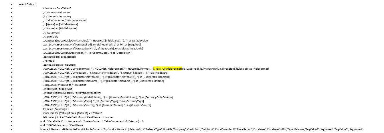

I’m doing some performance troubleshooting in relation to some BAQ queries that are impacting our server. One thing I noticed is that a whole second of work is needed just to prepare for a BAQ query. There is something that keeps showing up in the SQL profiler when we are running BAQ queries and it is one of the things that consumes the highest CPU (more than any of the work done by our customized query itself):
It looks like meta-data information (Ice.Column, Ice.Table, Ice.ZDataField).
Can someone tell me why this would take a whole second? Is there some kind of .Net CLR function that is doing a ton of work? Is there a bad index in use?
