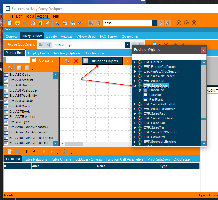

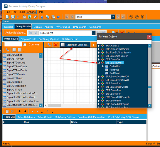

I can see tables with hundreds of columns being a frustration for users who haven’t fully experienced the data model gauntlet. I for one would want to do some curation of what’s accessible and what gets returned.
I guess I don’t see the advantage of having something do it on the fly. I suspect as soon as you started to use it you’d want to have “some” additional control that would require the ability to hide , show, filter etc fields and by that point you might as well go to a BAQ.
