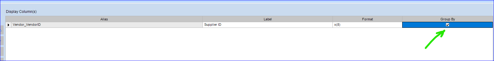

Sorry, stupid question… How? The only Group By I find is when I analyze/test it.
What @dcamlin said…I had four fields in my test (company, vendorID, name) and checked them all off…and added a calculated field to get max(InvoiceDate).

Add Vendor.Inactive and Vendor.VendorNum to your group-by selections. Whatever fields you select for display from the Vendor table need to be flagged as group-by.

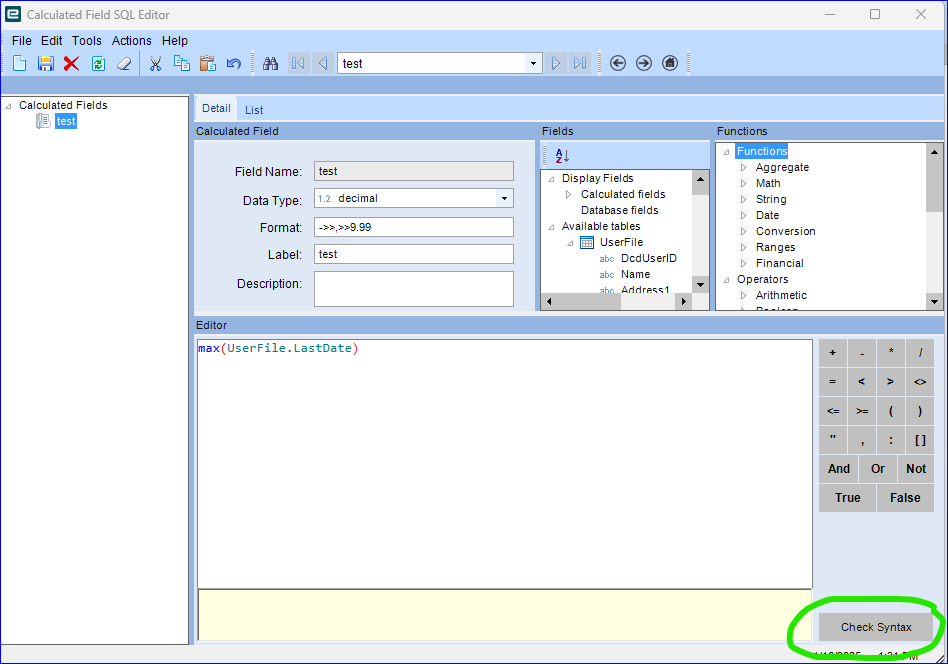

Here’s a tip…
When you have a calculated field, always click the “Check Syntax” button in the Calc Field Editor.
It doesn’t just look at the syntax of the Field… it looks at the whole query. So, instead of getting a “Bad SQL statement” error, it’ll give you more detail. Like, “Vendor.Inactive must be part of the group-by statement”… although, typically worded less useful than that
In cases of aggregate functions, if you use one (like sum, min, max, etc.)… you generally have to add all non-aggregate columns to the group by. But again, if you “Check Syntax” any errors that pop up will hopefully lead you in that direction.
Thank you both, it worked! I added all lines to Group By except the calculated field, and got the results I was looking for.
