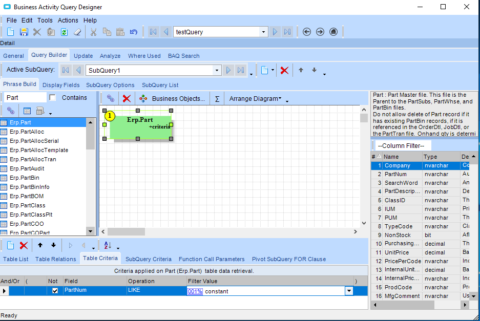

I came across your post regarding excluding part numbers that contain specific text. I have the same situation. I’m trying to exclude certain part numbers that contain certain text. It’s interesting that you can do it with grid filters but, I can’t figure out how to do it in the BAQ criteria. We are also SaaS on 10.2.600.
Were you ever able to get it to work in the BAQ criteria?
Have a look at this link. These SQL wildcards drive the LIKE statement:
Thank you fine sir! The answer was there.
