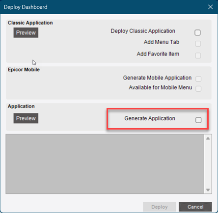

I have a BAQ that is working perfectly in classic and Kinetic. I created the dashboard in Classic first, just because I am still more accustomed to classic to ensure it could be done first, but when I create it in application studio, I do not get any data.
The purpose of this BAQ was to pull into a report showing the tooling we need to order. BUT we are trying to pull anything we can into a dashboard instead of a report. On the Classic Dashboard, I had filtered it to only show if Calculated_POCal is > 0, displaying all tooling that was below the threshold between on hand and on order.
Hoping someone can see an issue with my BAQ and let me know where I went wrong?
