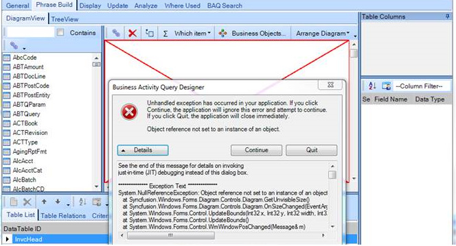

Is there a way to find out when a BAQ was last modified or updated? We are getting an “object reference not set to an instance of an object” every time we open the BAQ and then it errors if we ‘quit’ or ‘continue’ on the next error message.

As a workaround, we copied the BAQ and it worked fine. Not sure what happened to the original BAQ if a missing parameter or table caused the object reference error.
