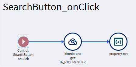

1. Modify the Search button onClick event to get the BAQ results using the entered search field as the BAQ parameter

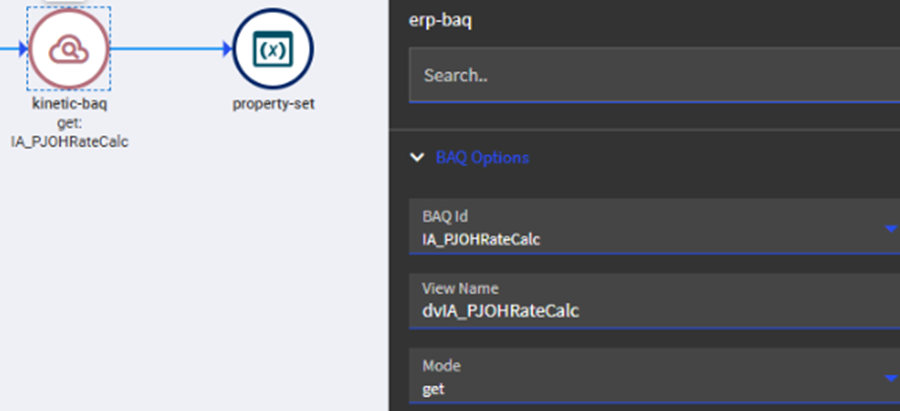

  • In the event, add a kinetic-baq widget to get the BAQ results. Place it before the property-set widget if it exists
  • On the Properties tab for the widget, BAQ Options, enter the BAQ id and View Name. Set Mode = get

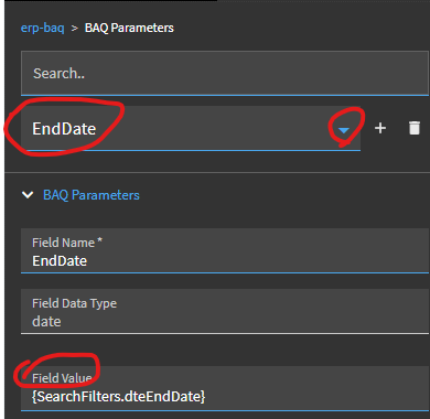

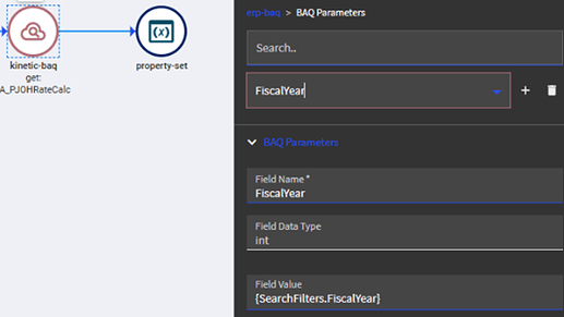

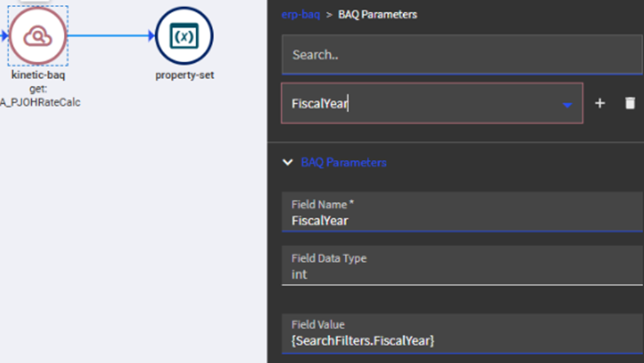

  • Open the BAQ Parameters section. Your parameters should be listed already. Set each one’s value to {DataView.Column} (the epBinding for your search field).
    e.g. Field Name = FiscalYear; Field Value = {SearchFilters.FiscalYear}

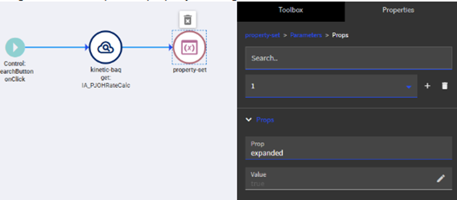

  • If you don’t have one already, add a property-set widget to the event, after the baq widget, to set the expanded property for the grid to true

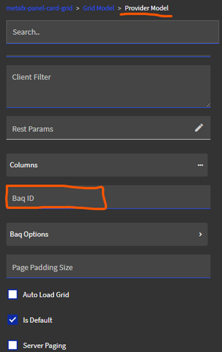

3. Remove the Provider Model Baq ID for the Results grid (avoids having to click the search button twice)

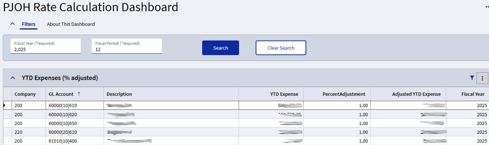

My Example:
Does anyone know how to get rid of that comma in the Fiscal Year integer field?
Have you tried changing the Mask property to >>>9?

I tried both >>>9 and 9999 and neither worked, unfortunately.

Now it does nothing. Could it be related to taking out the BAQ ID from provider model?
Any help is appreciated.
I did a test and it seems that whether or not the Baq ID is entered in the Provider Model, the text search field is ignored. If you do include the Baq ID, then you have to click the Search button twice to get your results. When I have some time, I’ll do some testing and figure out how to include additional filters.

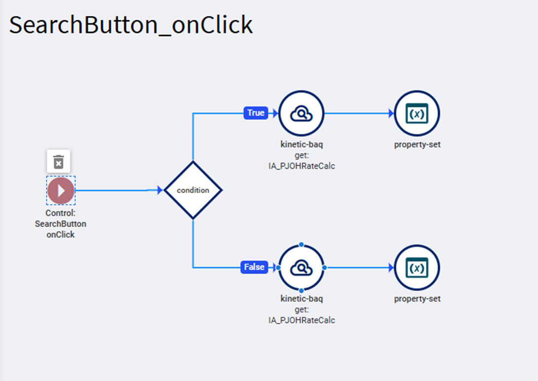

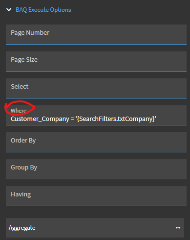

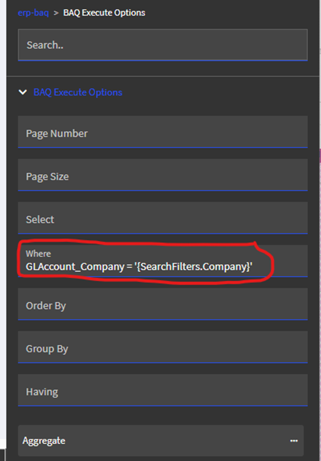

You can add the text filter to the kinetic-baq get widget in the BAQ Execute Options in the Where field (e.g. Table_Column = ‘{SearchFilters.Text}’) but this will fail (no results) if you don’t enter anything in the text search field, making it required.

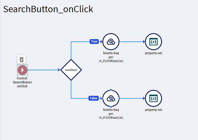

To get around that, you can insert a Condition widget at the start of the SearchButton_onClick event. If SearchFilters.Text is not empty (this expression worked for me: “{SearchFilters.Company}” !== “undefined”), execute the kinetic-baq with the Where clause set. If it is empty, execute the kinetic-baq without the Where clause. This works but it’s not scalable. If you have a lot of search filters, your condition checking could get messy.

One thing I haven’t been able to figure out. I’ve got a BAQ with three parameters, there’s a From Date and To Date which are required, but I’ve also got an optional parameter. The BAQ is set up in Parameter Entry with the optional text parameter to “Skip Condition if Empty”.
When I added the three parameters in the BAQ/Parameters area, it works as long as I enter the optional parameter. However, if I leave the optional parameter blank, then when I click the Search button, I think it’s recognizing that one of the parameters is not provided and it pops up the parameter slide-out.

Use a condition to check if you have the optional parameter set in a dataview or not {dataview.column} != "undefined" && {dataview.column} != '' or so, if you do have a value in there, branch true to an erp-baq widget with the optional parameter piped in. if you do not have it set, branch false to a copy of that erp-baq widget with optional parameter set to “send empty”
