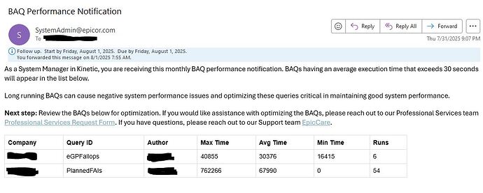

Good morning,
I got an email from Epicor last week notifying me that two of my BAQs are long running and can affect system performance. They show a max and average time that is way higher than anything I regularly experience. I just went to try to optimize my BAQ, but it runs plenty fast. Is this a warning based on a test run that I might have done that took too long to respond?
Do you see anything in this BAQ that looks wrong? I know I am pulling over a hundred thousand lines of part trans, but it still runs fast in my experience.
This BAQ is called Planned FAIs. The goal is to look ahead at the orders we have, and then look back at the part transactions. MFG transactions in the last 2 years mean that we do not need to do a new First Article Inspection, anything older than 2 years mean we do need the FAI. This attempts to look ahead and quantify the potential sales value of orders with upcoming FAIs. It does the job alright for now.

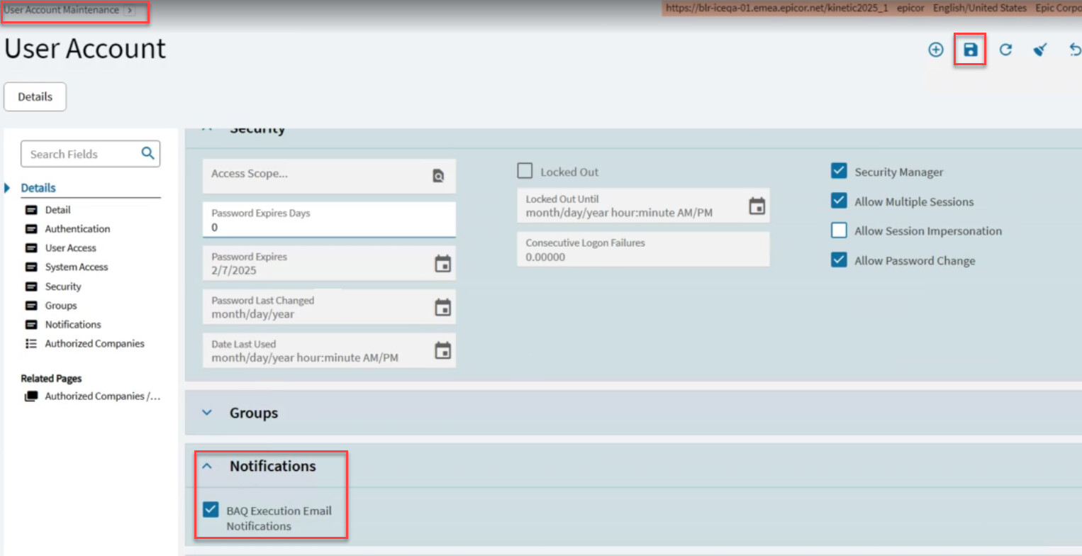

You can turn the emails off here
Kinetic monitors the performance time, or execution time, of each custom (non-system) business activity query (BAQ) that runs against your database. Kinetic has an Execution Time Threshold that defines how quickly each BAQ should run so that it does not slow the performance. This default threshold value is 30 seconds.
If the average execution time of a BAQ is longer than this 30 second threshold value, Kinetic captures this information and sends a BAQ Execution Summary email to users with Security Manager access. These individuals can then explore ways to improve the performance of these slow BAQs.
Kinetic sends out this BAQ Execution Summary email once a month. This email will usually arrive on the 1st of the month. However, the first time Kinetic runs this performance test, the email may appear on a later date.

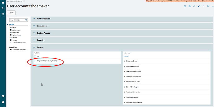

Could it be performing poorly due to the BAQ Territory Security thing?

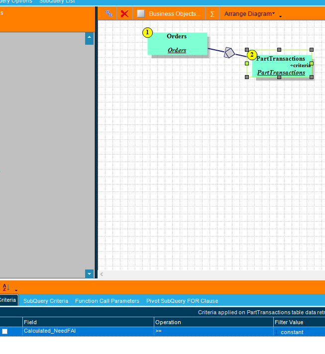

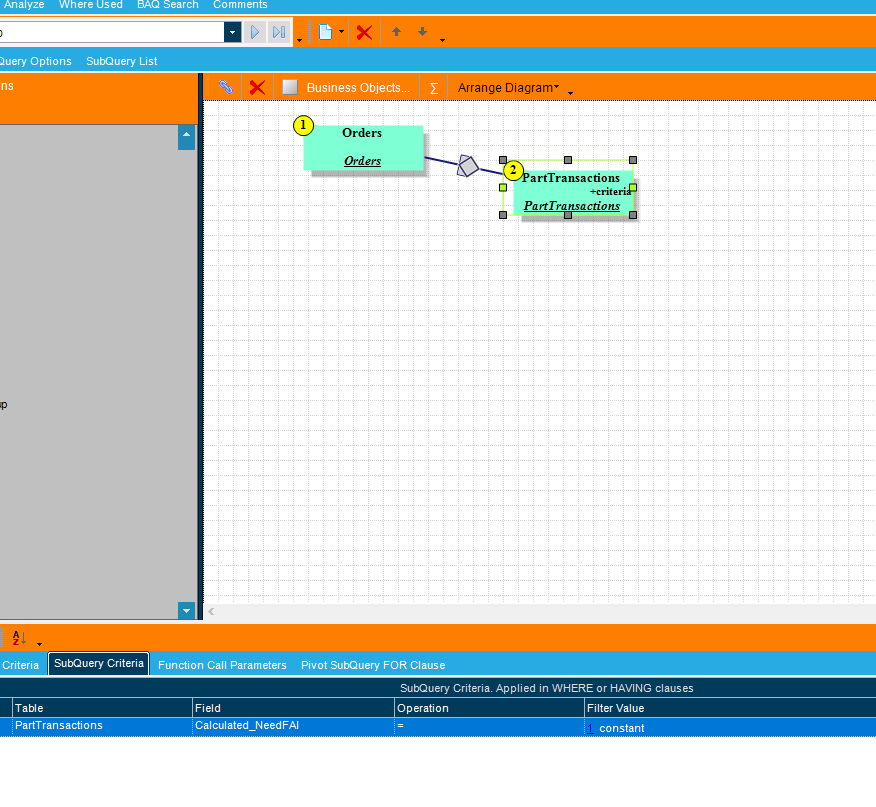

In your BAQ you are Filtering the PartTransaction subquery where Calculated_NeedFAI >= 1
But then in the Subquery criteria you are only returning data where Calculated_NeedFAI =1 that seems contradictory / redundant.
