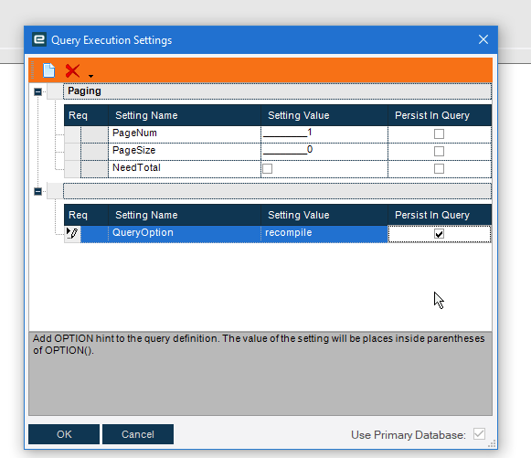

Usually that’s a SQL issue. Try adding option (recompile) to your query and see if a new plan kicks it into gear.

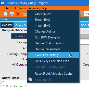

I’m assuming your on the latest since you’re cloud, and if so, you should have the feature to add that in the execution settings.
Give that a shot and see if that fixes it.
If the BAQ has parameters odds are it’s a case of Parameter Sniffing, and @Banderson 's suggestion should work like a charm.
Thank you @Banderson for the suggestion.
I tried that execution setting - I do not think it is working. I ran a test for a range of One day and it took 12min - that is the same number was getting earlier.

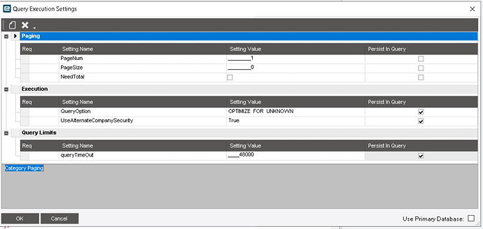

OPTIMIZE FOR UNKNOWN
Instead of RECOMPILE @DaveOlender. If its a parameter sniffing issue this might solve it. If this and RECOMPILE didn’t help then its bad Stats and or Idex issues and for a shared cloud instance that’s gonne require Epicor to do something.

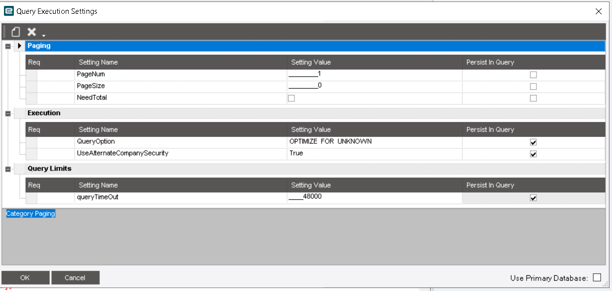

Thank you @josecgomez and @Banderson - the OPTIMIZE FOR UNKNOWN and “UseAlternateCompanySecurity” combination did the trick. The full month now runs in 49Seconds.

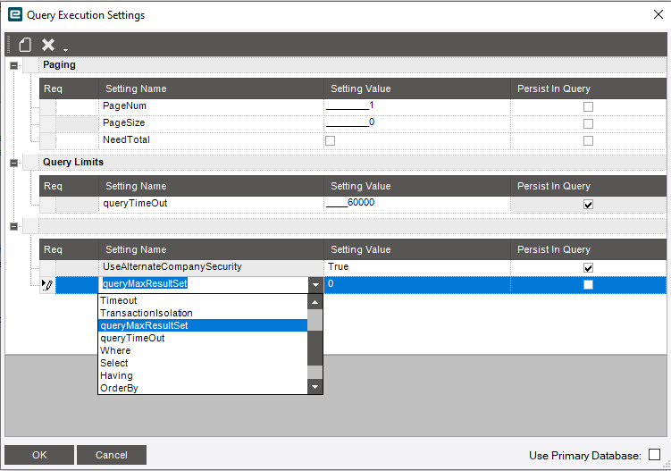

Well, now I’m curious, what’s “AlternateCompanySecurity”? I’ve never seen that before, and if the name is anything like it sounds… we could use that! lol.
Mr. Brandon: I am not really sure what it does. I run into this whenever a baq runs in Pilot but not in Live. Epicor Support suggested this as a fix many moons ago and i found that i can switch between it being on or off and it will help us get the BAQ to run.

@pferrington what does UseAlternateCompanySecurity do differently?
It uses old company security that was reimplemented at some point.
In some queries it works better, because sql server creates better execution plan.
So it is up to you to test both and to select what works for you. Or use extbaq like you do already
Do you know if this is only available in newer versions. We are on 2021.2.8.I can add UseAlternateCompanySecurity, but not the QueryOption even if I type it in.
I have a BAQ that is executing slow (152 rows returned in 200,000-450,000 ms) for some people, but fine for others (152 rows in 30ms). It seems like this could solve the issue.
Query option was added in 2023.1
However there are ways around it using group by hacks
or ORDER BY :grinning:
