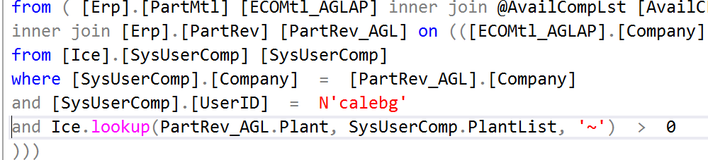

Digging into why and using the SQL Profiler, I get the actual SQL executed. Every time a PartRev table is used in the query, Epicor appends a clause “Ice.lookup(PartRev.Plant, SysUserComp.PlantList, ‘~’) > 0” and that seems to be the culprit. Removing those where clauses and rerunning it makes the query run as expected.

I’ll after doing a quick test using the same where clause, just querying the PartRev table in SSMS, it took 4 seconds to read 67k rows. That’s terrible!!
Select * From
Erp.PartRev
WHERE ( [PartRev].[Plant] is null or  Exists  (select 1 [c1]
from [Ice].[SysUserComp] [SysUserComp]
where [SysUserComp].[Company]  =  [PartRev].[Company] and [SysUserComp].[UserID]  =  N'myusername'
and Ice.lookup(PartRev.Plant, SysUserComp.PlantList, '~')  >  0
Like @josecgomez said, this restricts the user to the plants they have access to. Epicor can also add more filters for tenancy (for mutli-tenant users), and sales territories for those using the CRM module.
