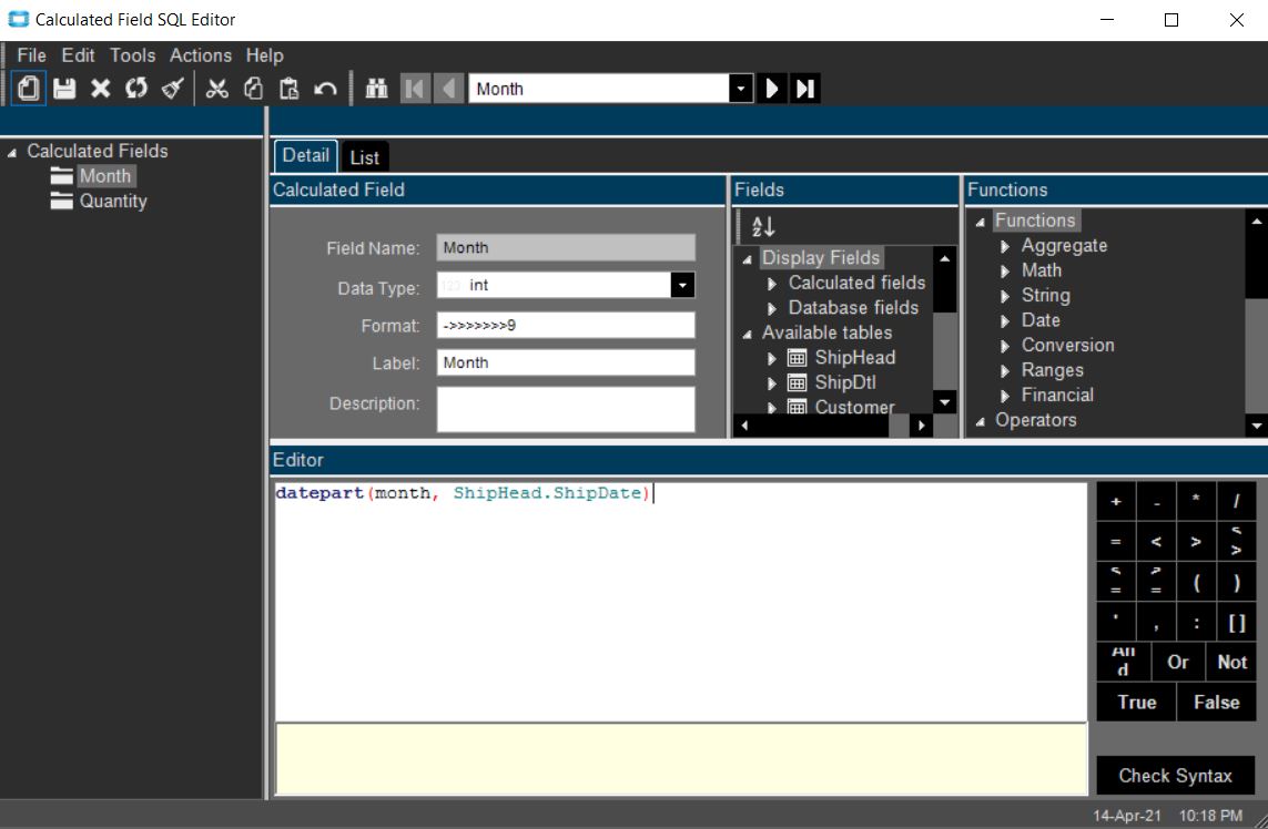

  2. Make a custom column to extract month from the Date column

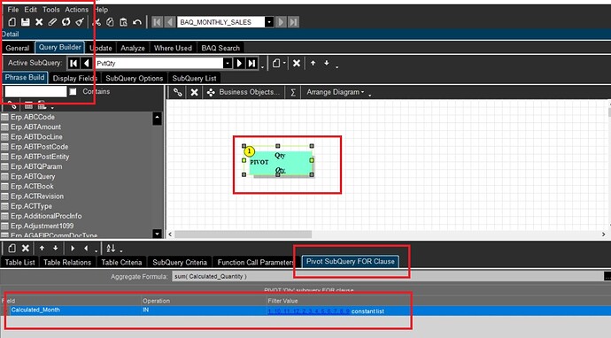

  4. Right Click on the dragged item and select Pivot > Set Pivot.

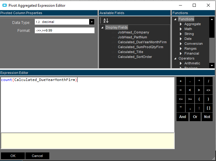

  5. In the Pivot Agreegated Expression Editor use formula like Count, Sum etc…

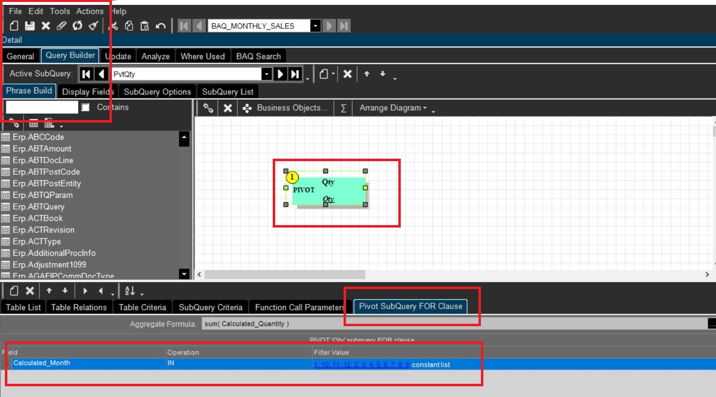

  6. Select the Calculated Field under Pivot SubQuery For Clause
  7. In the Filter value column select Constant List and enter Months as per the below screenshot.

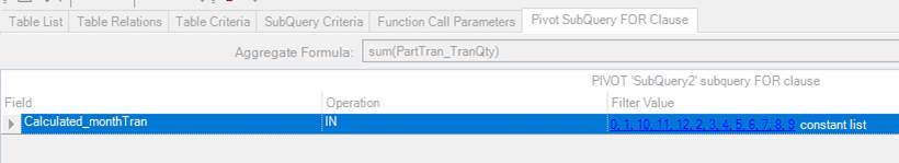

Expression editor should have the value that you need for the different months like count, sum of something. Like in the example below it is the sum of tranQty.

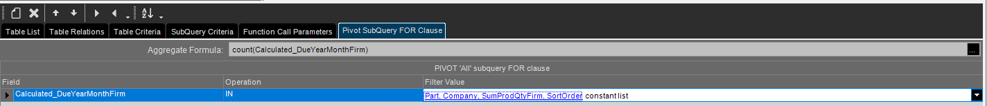

In the FOR clause the field is the field which has month in it and then it has to be specified as a constant list as the example below.
