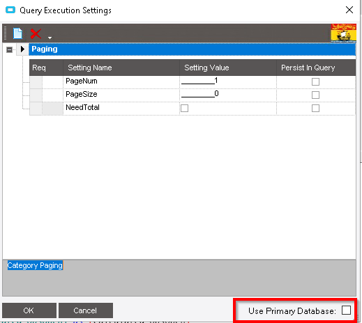

In 10.2.500 under the Query Execution Settings I see a new check box labeled Use Primary Database. I have searched but I am unable to find any documentation on what this is for. Does anyone know what this will do?

I came across this post, as we are setting up new SQL Servers using Always-On Availability Groups. What this will do is off-load BAQs to your Secondary Server and its databases if the Read-Only Routing is configured.
