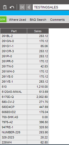

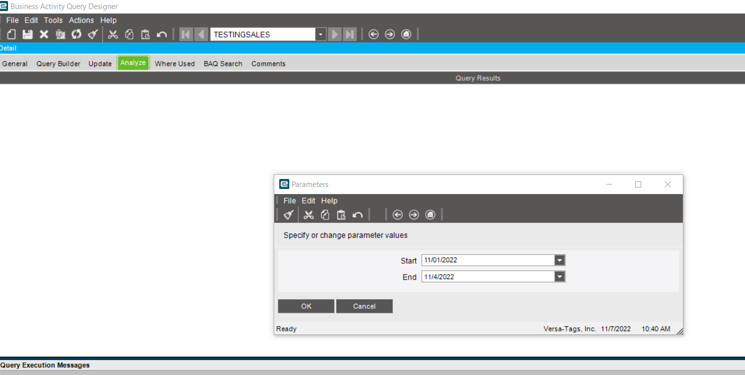

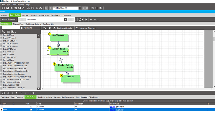

Thank you for the quick response. I am very new to this, and having a little trouble understanding what your suggesting I do. I am wanting another column with the prior years sales within the same date range in my result.
I am attaching snips to show what I have so far.
If you use the criteria ShipDate>=@Start and ShipDate<=@End you won’t be able to get previous/next years as it will limit the BAQ result to just the period you selected there. So you need to extend that to 1 year in both directions. In your criteria there, use an expression instead of parameters. You will have something like:
ShipDate >= DateAdd(year, -1, @Start)
ShipDate <= DateAdd(year, 1, @End)
You would then need 3 calculated fields that show the 3 periods: previous year, current and next.
Current should be like sum(case when ShipDate between @Start and @End then YourSalesValue else 0 end) - in case you used group by.

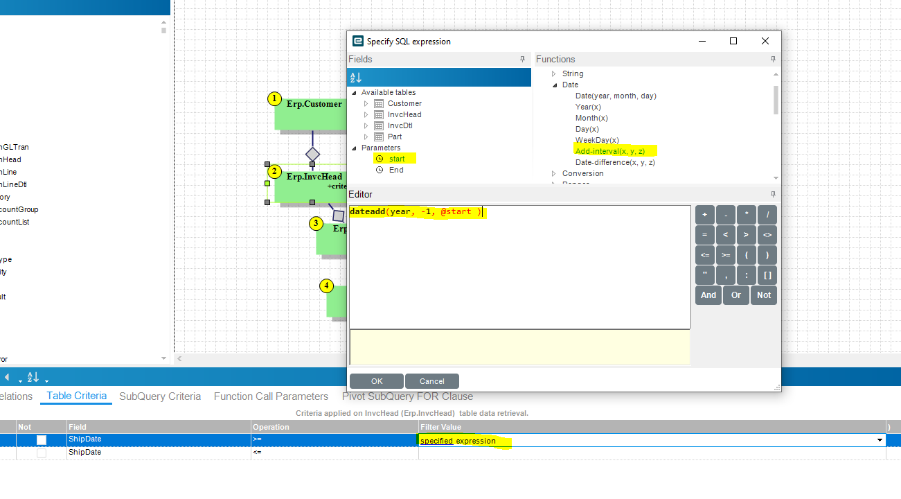

Instead of using the filter value “specified parameter” use the one called “specified expression” for the CTE.
When you click on “specified” the expression editor will pop up, that is where you will enter the “dateadd(year, -1, @start)" (replace @start with your parameter).
What this will do is run the CTE with the same time period, minus one year, as the original query.

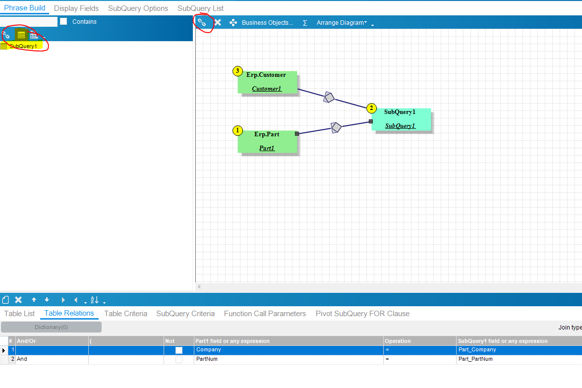

Once that is done, you will be able to go to your “toplevel” query (SubQuery1) and add the CTE in as a table.
use the link looking tool to add a connection (click the button then click the first table you want to join then the second table)
In table relations, match the fields together that you want to match and change the join type to “all rows from table in your query”. The connection should change to look like the ones in the picture.
