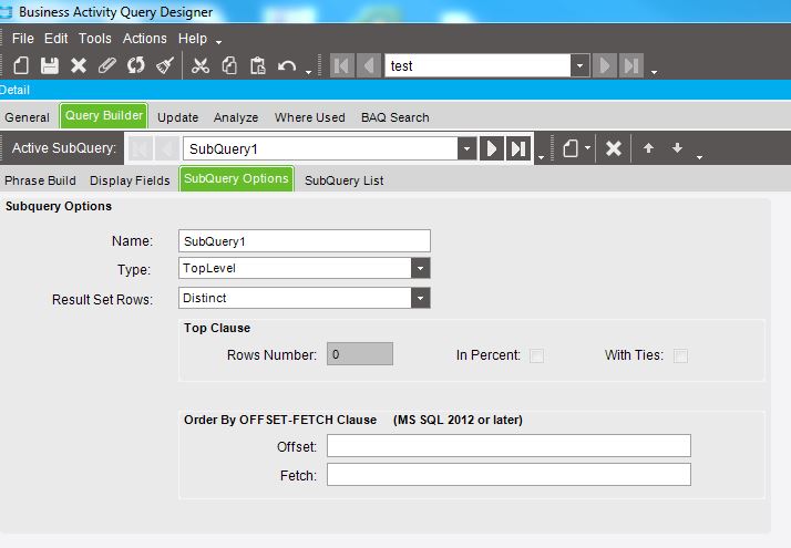

Yes this would need a subquery.
the final query would be something like
select distinct(master.jobNum)
from ERP.PORel As master
where
master.JobNum NOT IN (select distinct (JobNum) from PORel where OpenRelease = true)
How do I get something to be distinct in the Epicor BAQ Designer?
