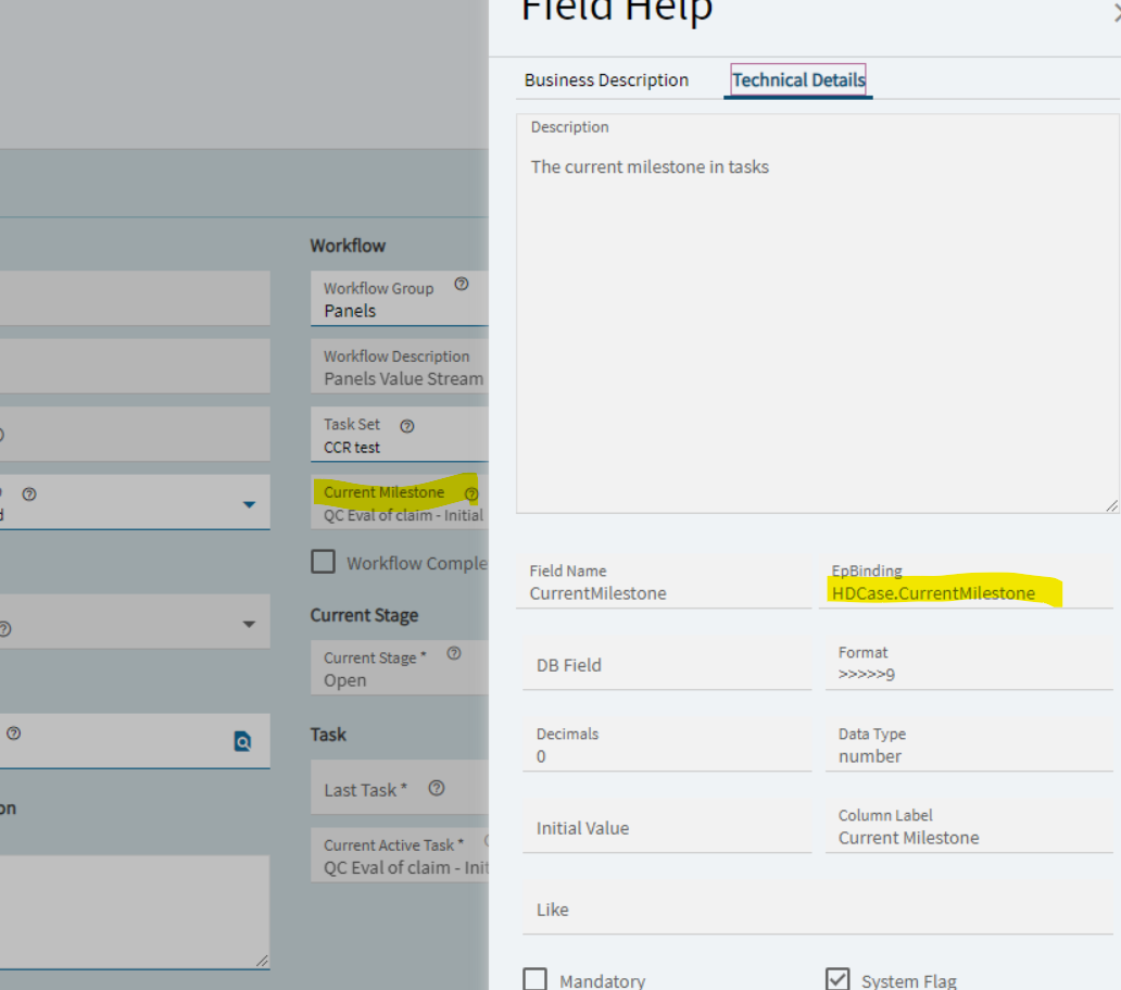

I need to derive the current milestone in a BAQ for a dashboard for open cases and tasks. I’m not seeing a clear definition of how that’s defined in field help or otherwise

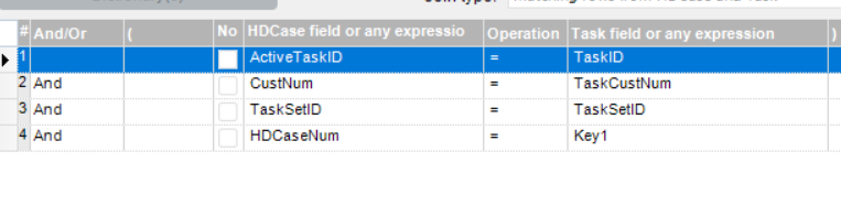

I think I have the answer. Not sure if anyone can confirm or deny. It seems I can reliably join HDCase to the active task in the Task table with the following criteria.
I can then use the Task Description for my current milestone for my baq results
