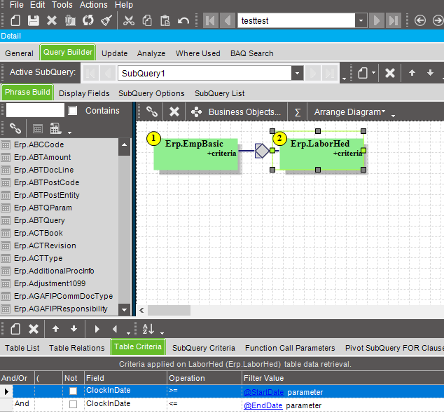

If your first table is the Emp Basic table, you could throw a left outer join on the LaborHed/Dtl table. This would make always at least one record show on the report.

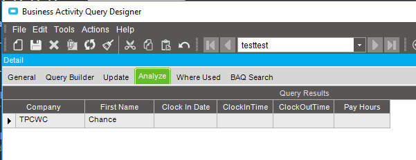

Take a moment to poke around with what I’m suggesting. No records would be returned if LaborHed is joined with an Inner Join. If you change it to a left, records would still be returned in the report for employees without time.
I’ve never clocked a single hour, but my employee record still gets returned.
I have done what Chance said.
