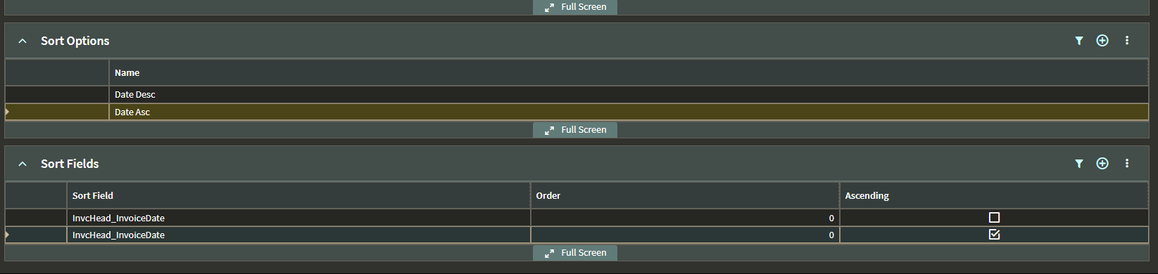

I am quite new to using BAQ reports outside of report selection options. I am having reports generate but not actually download / open which leads me to believe that I am doing something wrong with my sort options. (Also the report runs as normal without any sort options)
I would like the user to be able to select from sorting by date ascending or descending. Any assistance is appreciated :slight_smile: :slight_smile:
I am confused what the link between sort options and sort fields is.
Solved:
I am using the SortBy column inside the actual report to show/hide differently sorted tablix.
