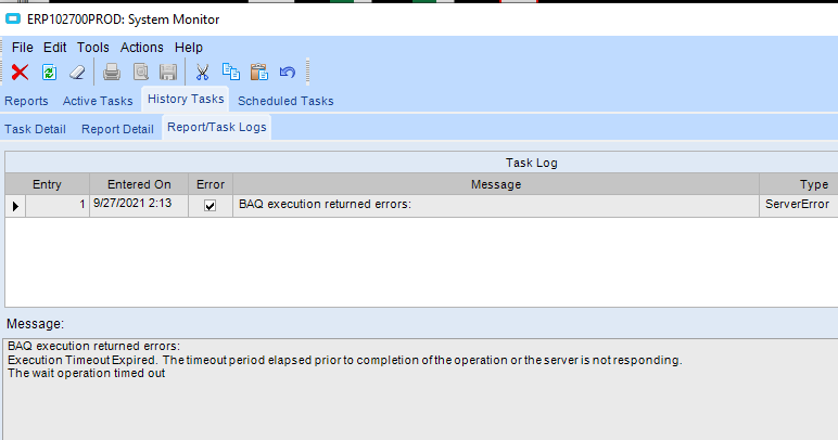

We have a BAQ Report that ties out to a SSRS Report Style. When one particular user submits this report, the report stays in running tasks and will eventually time out. The issue is that we only see this behavior for this specific user at this time. When we run this BAQ report with the same report style and criteria as another user, the report snaps back in seconds. We have done this from the same PC logged in as different users. This PC hits the same server on the same LAN.
Timeout:

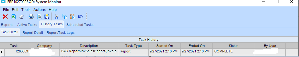

But we had the same result for this user with the bumped up execution time on the underlying BAQ for this BAQ report.
We have run this report from the same PC logged in as two different users, one who has the issue and other users who do not. The reports (and the underlying BAQ) snap back quick and return the data. We are running this report with fairly concise criteria as well. The data set is not really that big.
