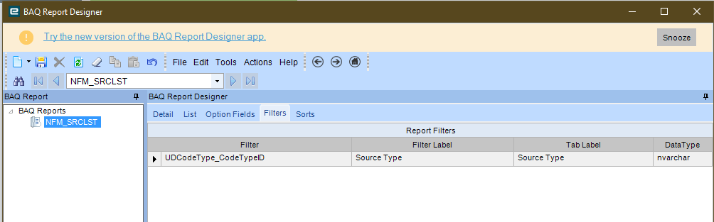

In either case, make sure the target field is included as a display field in your BAQ.
In BAQ Report Designer, you should be able to use that field as a filter, by adding it under the filter tab:
