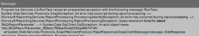

This is the error I get…
From looking thru the forums it looks like it’s an SSRS config error but I have no idea where to start since both BAQs are identical and work fine as long as I call it as a BAQ Report and not a Report.
Anyone have any insight before I have to try to get ahold of Tech Support? Thanks.
it is pointing at the query for the BAQReportParameter dataset. I would try dropping the “dbo.” at the beginning. However, you can paste the SQL here to see if we can help.
I used the BAQ Designer to make the reports so I have no idea where that field is coming from…

And, that is where it appears to have gone wrong. Whatever you did to edit it caused this issue. The issue lies in the BAQReportParameter dataset. If you paste that SQL, we can likely help find the problem.
well then I’m completely lost because I never edited or touched any SQL, that query I pasted is the pseudo-query generated from the BAQ internally using the designer. The @start and end dates were linked via the Report Style definitions.

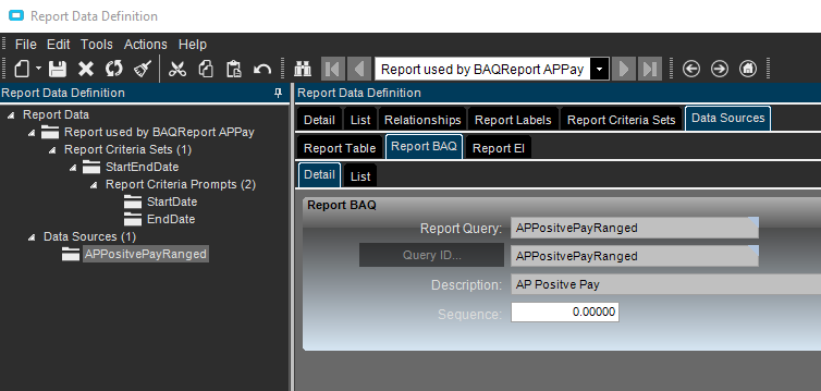

nope, I already did that too. It’s already linked in the data definition. when I originally forgot to do that it was throwing a completely different error saying the parameter was missing.

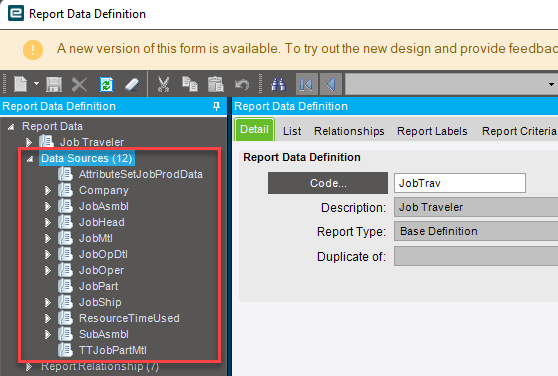

I think you may be onto something, in the RDD under data sources should I have included all the tables that the BAQ report is pulling from because I only listed the BAQ as the main data source?
No, you do not want to do that. The two “types” of reports are different and use different datasets. You want to create a separate RDL for each type. You cannot use the same RDL file for each “type” of report.
