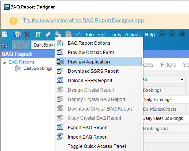

Mr. @Graemer you should be able to preview the baq report as an “Application”.
Then add the Kinetic App reference to the BAQ Name and the kinetic version will run even from your classic screens.

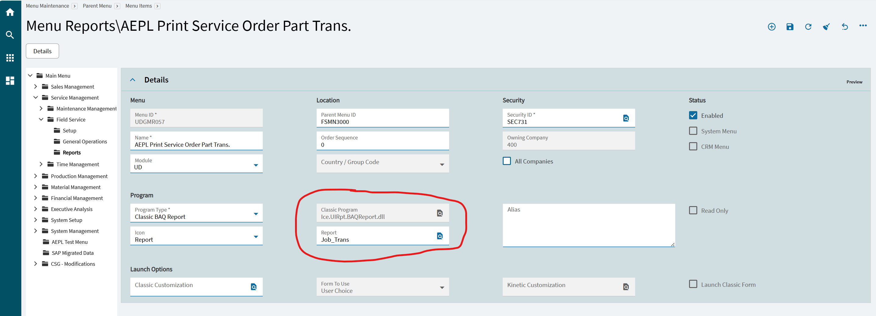

Thanks Dave. Maybe I am missing something in your explanation but the menu option for a ‘Classic BAQ Report’ does not include and entry field for the ‘WebURL’ so it is difficult to do what you are saying.
I took a look on my test system and there is a ‘Q’ option type for ‘Reports’ but it appears to be for Crystal and other types of reports. There is one system BAQ report that includes a webURL in the menu option definition but it still prompts to say it needs to run in classic when I click on it from the browser.

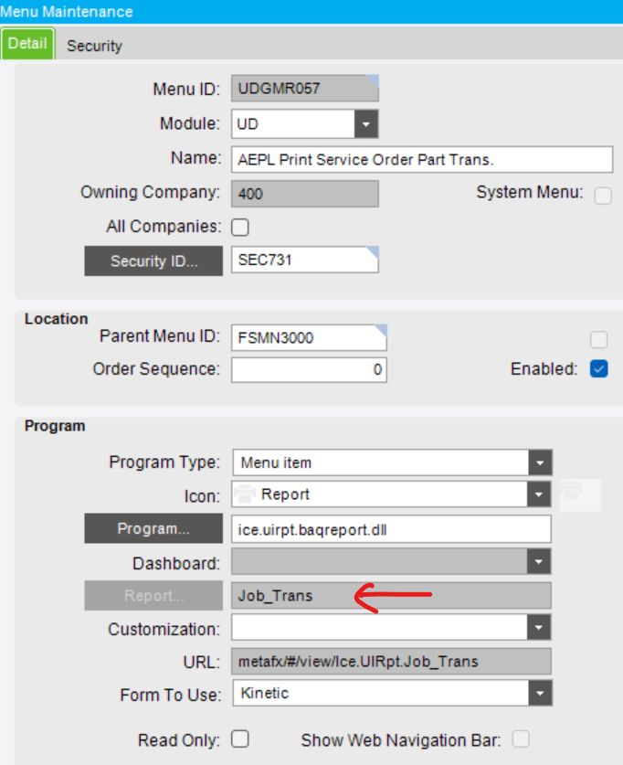

OK, Got this solved. I converted this into a Menu Item which allowed me to enter the old program as well as the web URL:
The report parameter I had to manually update but it displays on the Classic menu maintenance screen.
Going forward I might be able to do a customization of Menu maintenance to allow updating the report name without using a SQL update or Updatable dashboard.
When I tested this I was able to get the Kinetic screen when in the browser and the classic screen when calling from the classic client.
