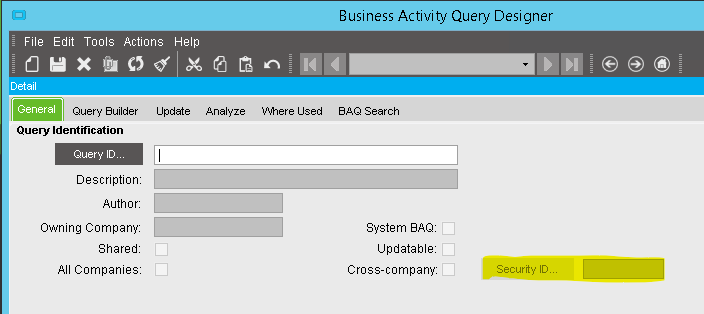

I haven’t used it yet, but I think that is what the BAQ Security ID is for:
@Jason_Woods,
We tried using that, but that made it to where the dashboard in question was unusable to all other users. We want the dashboard to work for everyone, but the tab that calls that specific baq to not show or be enabled for them.
